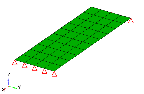

The frequency analysis setup is already made for this model where the one end of plate is clamped and the loading is applied on the other end (two different sources of the loading, thus two subcases). The loading frequency is defined by the FREQ1 card; from 20 to 1000 Hz with an interval of 20. The same loading frequency is applied on both the subcases.

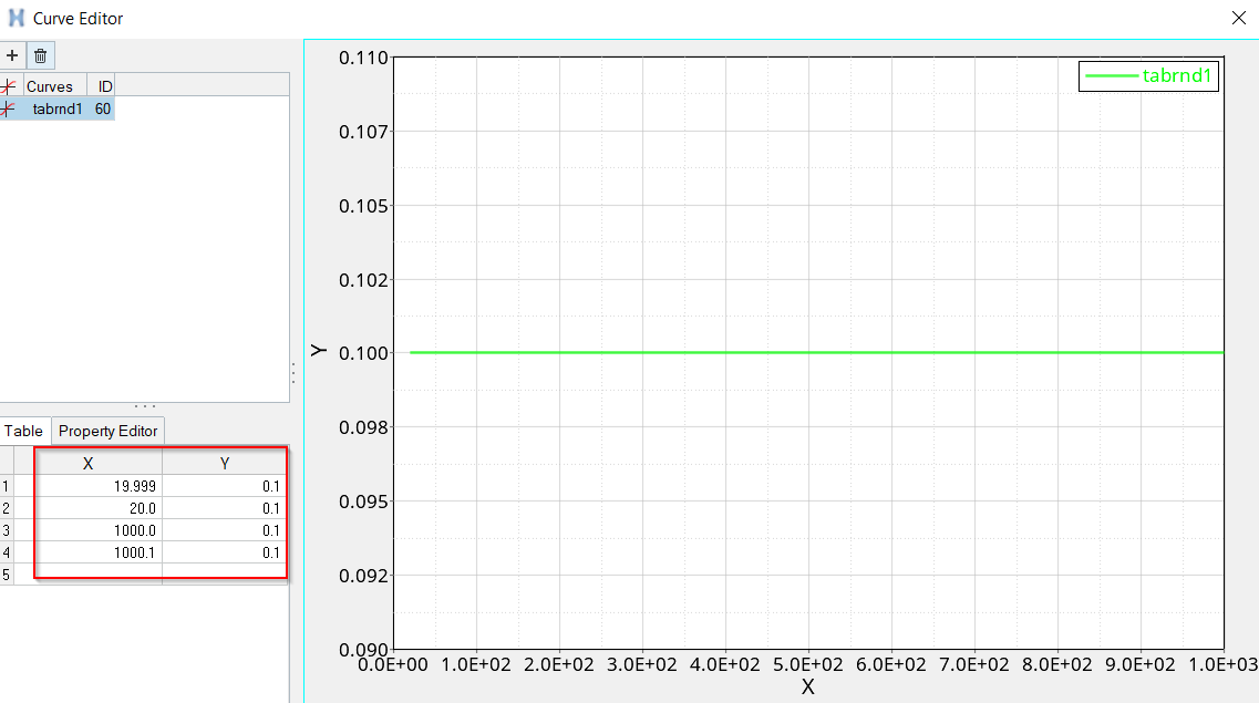

Create TABRND1 Curve

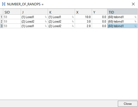

Create RANDPS Load Collector

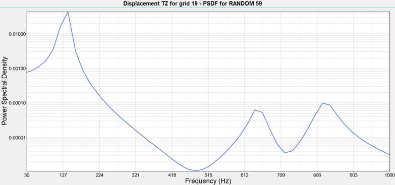

- HyperView script file. This file will automatically create the plot of PSD over the frequency for the results contained in .rand file.

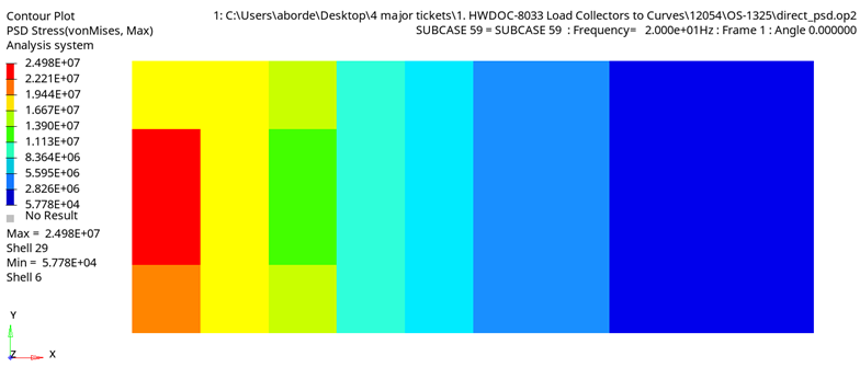

View the Results
This step describes how to post-process the RMS and PSD results in HyperView.
