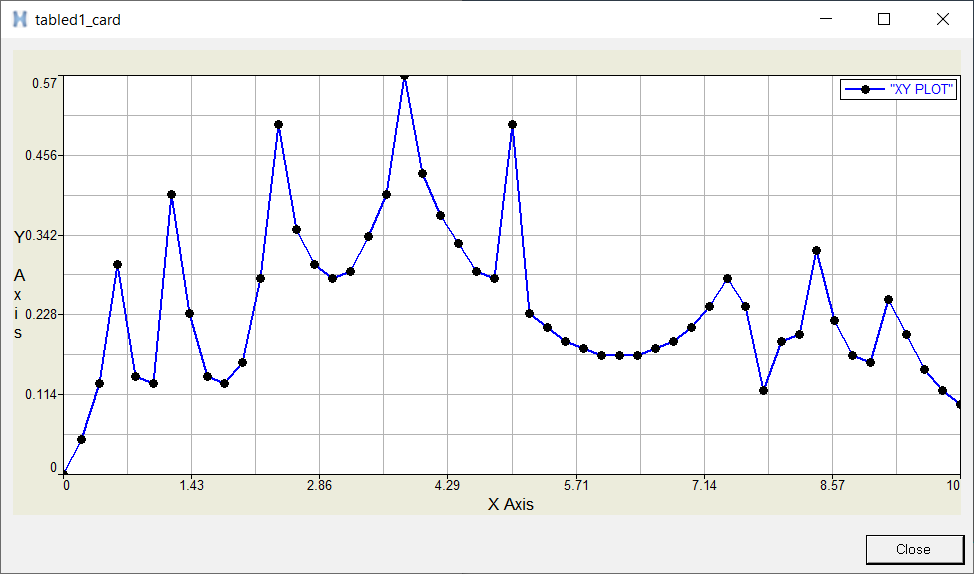

Define the Input Response Spectrum
Define the DTI, SPECSEL Card
This card specifies the type of spectrum and damping values associated with the input response spectrum defined using TABLED1 card in the previous step.

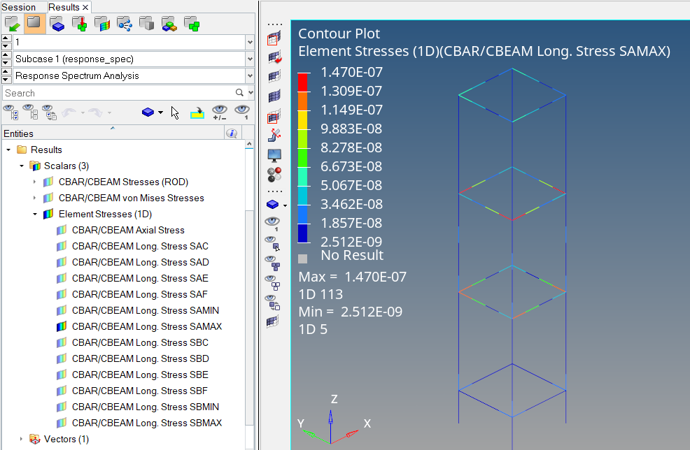

Define the Output Request

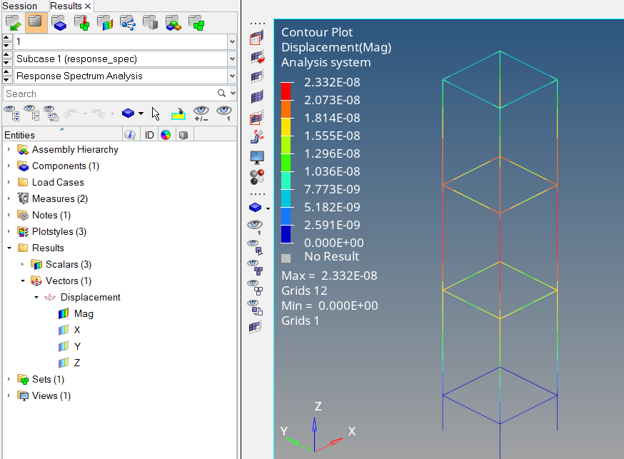

Displacements are output by default.
- To output stress from the Analysis page, enter the control cards panel.
- Click next to the page which has the GLOBAL_OUTPUT_REQUEST panel.
- Click GLOBAL_OUTPUT_REQUEST, scroll down the list to STRESS and check it.
- For OPTION(1), select ALL.
- Click return twice to exit the control cards panel.
