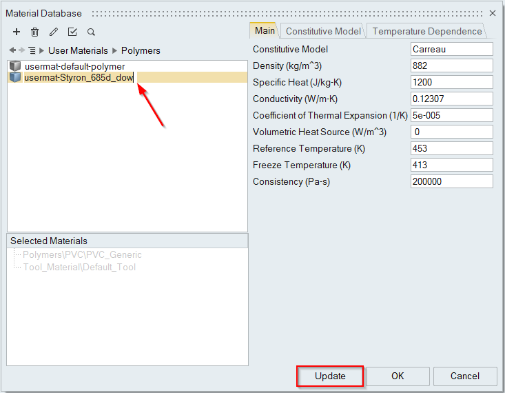

Selecting Materials
Use the Materials tool to select materials for the analysis.

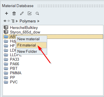

Fitting Materials
Use the Materials tool to fit materials.

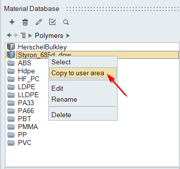

Copying Materials
Use the Materials tool to copy materials.
