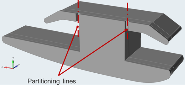

Figure 3. Partitioning lines highlighting where the land solid should be split at the interface of the polymers.
