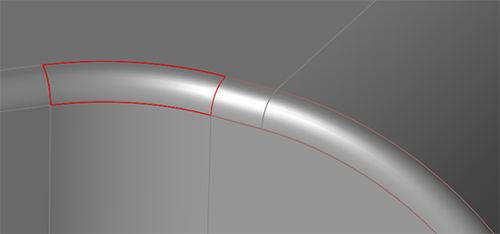

- In some cases an analysis run can't be completed because there are missing or overlapping surfaces on a part.
- If you have Mass Calculations turned on in the Preferences window, the mass of the part shown in the Model Browser will generally be zero.
- It is also common to see some red and some pink edges in the modeling window
where the surfaces overlap.
