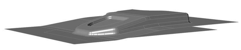

Open the Model
- From the File menu, select Open.
In the Open File dialog, navigate to the file in the
tutorials folder in the installation directory in
Program Files\Altair\2022.3\InspireForm2022.3\tutorials\pan.x_t.
The model should look something like this:

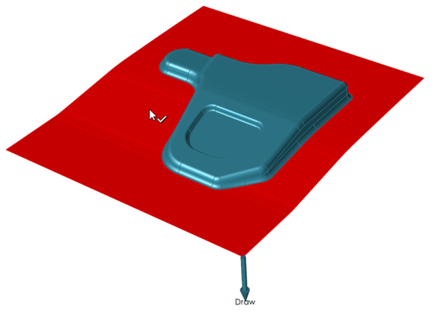

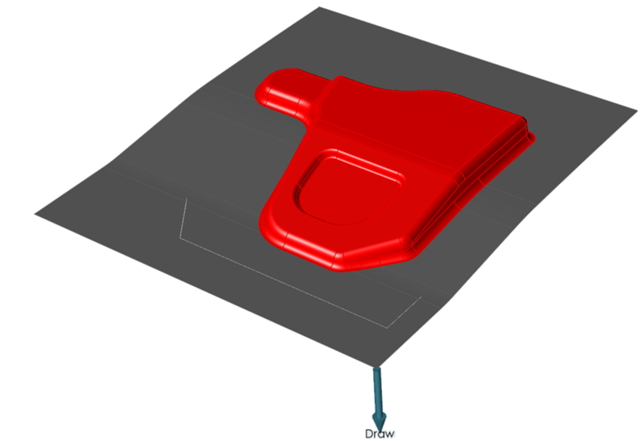

Define the Blank and Material

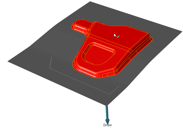

On the Tryout tab, click the Blank icon.
- In the microdialog, click Single Blank for the blank type.

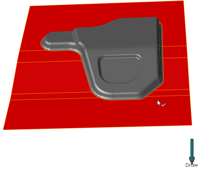

On the model, select the blank.
Note: To easily see the blank in the die set, you can hide parts that are blocking the view of the die. To hide a part, select it, right-click, then select Hide. Once you define the blank, unhide the parts.The blank turns red indicating your selection.
To confirm the blank selection, on the model, select the blank again, or on the
microdialog, click Assign.
- Once your selection is confirmed, the blank surface is displayed in a light gray color as indicated in the legend. Also notice in the legend that the dark gray color on the model indicates surfaces that are not yet defined for the analysis setup.

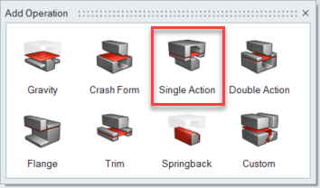

Set Up the Single Action Draw Operation
From the Tryout tab, select the Add
operation icon.
From the Add Operation window, select Single
Action.
The Single Action operation is added to the Tryout ribbon. -

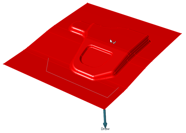

From the tool set, select the Top Die.
- On the guide bar, choose Part.
On the model, select the part for the top die.
Click to confirm.
The part is assigned as the top die. A microdialog appears to define the stroke.
- On the microdialog, for the stroke, keep the default To Closed position.
- Click to confirm the default stroke.

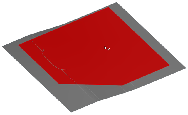

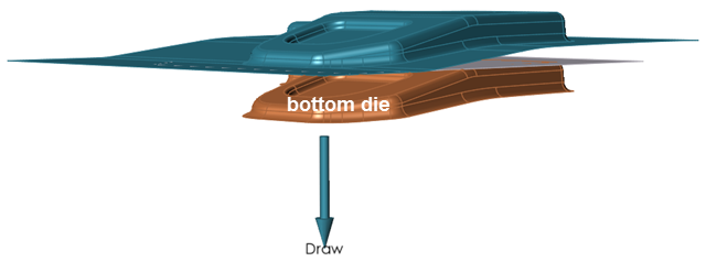

From the tool set, select the Bottom Die.
- On the guide bar, choose Surfaces.
On the model, select the surface of the top die.
The selected surface is highlighted in red, however, this is not the correct surface to offset. To isolate the correct surface, reverse the current selection. -
To reverse the selection, press
Ctrl+R.
The selection of the surface is reversed.
Select the new surface.
A microdialog appears on the model for you to enter a value for the offset. The default value is the thickness of the sheet plus 20%. In this case the value is .1.2 mm. - Click to accept the current value.
Click to confirm.
The bottom die is added to the tool set.

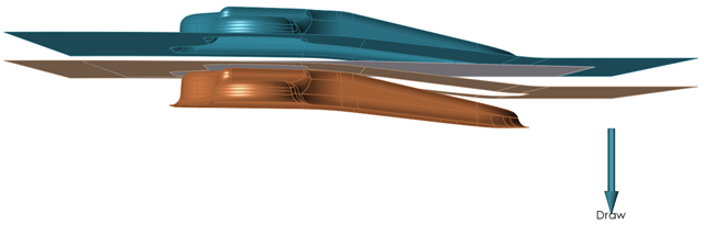

Position the Die Set

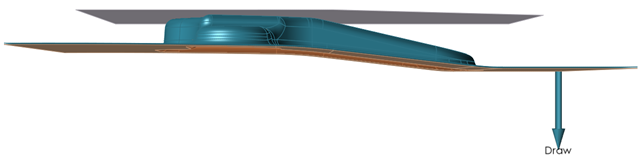

lets you adjust the position of the die set between the
open and closed states. The position of the die set can be defined automatically or
manually. -
On the ribbon, hover over the single action draw operation that you added to
the anaylsis.
Click the Edit Position
icon.
Examine the tool set in the closed state: in the three fields of the guide bar,
choose Closed, Auto and
Position.
The software automatically positions the tools to their closed state. -
Examine the tool set in the open state: in the three fields of the guide bar,
choose Open, Auto and
Position.
The software automatically positions the tools to their open state. Keep the tools in this state.
Note: A manual option is available for you to manually define the open and closed positions of the tools. -
To preview the forming action of the current tool set, on the Single Action
icon, click Edit Action
An animation of the forming operation is generated for the model. After examining the animation, you can make modifications to the tools as required.

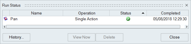

Run the Tryout Simulation
From the Tryout tab, Run tools, click Run Analysis
In the Run Analysis dialog, type in a name, and click
Run.
Note: By default, the run name is the model name, and is saved in the run history directory that is specified in the Preferences.The Run Status dialog shows the progress of the simulation. A green check mark indicates that the run is completed.

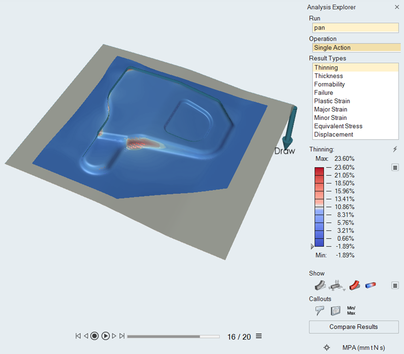

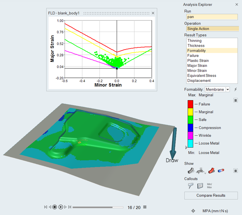

Review the Simulation Results
The Analysis Explorer lets you choose a variety of results to review. An animation for each result type is included. By default, the results for thinning are displayed on the formed part.
Figure 1. Results for Thinning
With the slider below the model, you can review the forming of the model.
- Adjust the results slider to see what areas on your model are under the greatest thinning.
- To animate the results, click the play button. To jump to the first or last step, click the left and right arrow buttons, respectively.
- To adjust the animation settings for playback, display, or speed, on the
slider, click
To view additional results, from the Analysis Exporer, select a Run, Operation,
and Result Type.
Figure 2. Results for Formability
