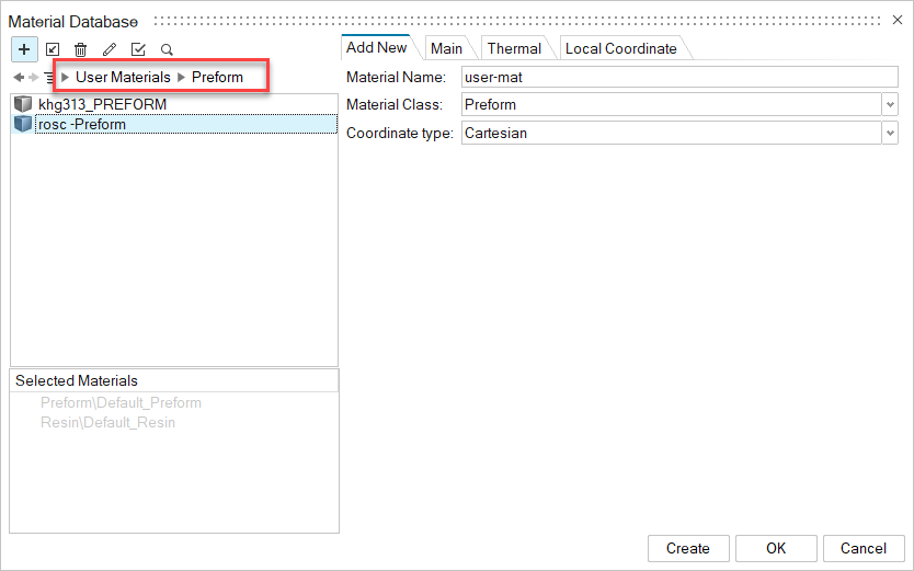

Tutorial: Adding a Preform Material
Add a new Preform material to the Material Database.
