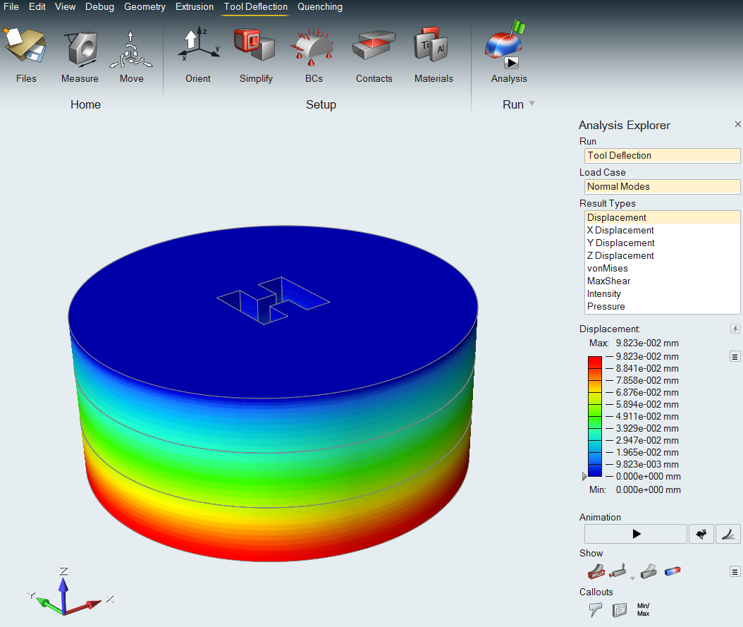

Animation Options
The animation options on the Analysis Explorer allow you to start and stop the animation and adjust basic settings.
| Option | Description | |
| Play/Stop Animation | ![]() |
Animate the selected result. |
| Animation Speed | Change the speed of the animation. | |

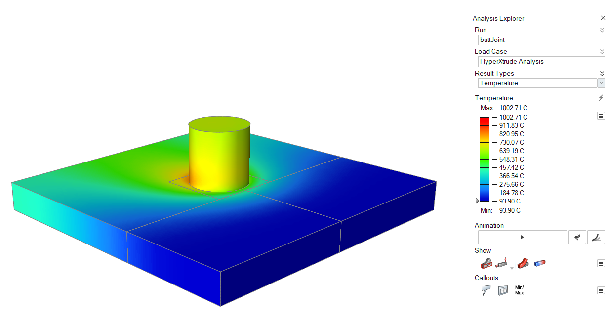

Result Types
| Temperature |
The flow stress of a material is a strong function of temperature and strain rate. In addition, key material characteristics such as grain size depend on temperature. Hence, understanding the temperature distribution is the key to quality friction stir welding. The localized heating around the tool is generated by friction between the tool and the workpiece. Temperature data is used to determine where excessive heating occurs between the plate and welded plates. The temperature during friction stir welding should be well below the selected material melting point (around 400°C-480°C for AA7075). |
