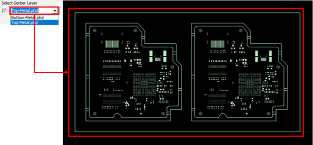

Select Gerber Layer: Select a Gerber Layer to select outline and bridge
object of panel board. The selected Gerber layer displays on the screen. Figure 1.

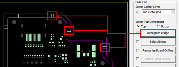

Recognize Bridge: When the unit PCB outline and the panel PCB outline are
parallel, a pair line at the right angle is regarded as a bridge region. The
bridge area should be recognized to distinguish the unit PCB outline from
the panel PCB outline. Figure 3.

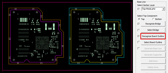

Recognize Board Outline: This menu distinguishes and recognizes each closed
outline considering the connection status of the outline. The closed
outlines display in different colors when you click Recognize
Board Outline. Figure 4.

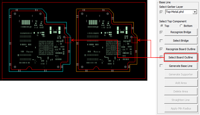

Select Board Outline: Board outline is created based on the unit PCB outline
when creating the base line. Select the outlines corresponding to the unit
PCB among the outlines separated by clicking Recognize Board
Outline. Figure 5.

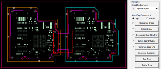

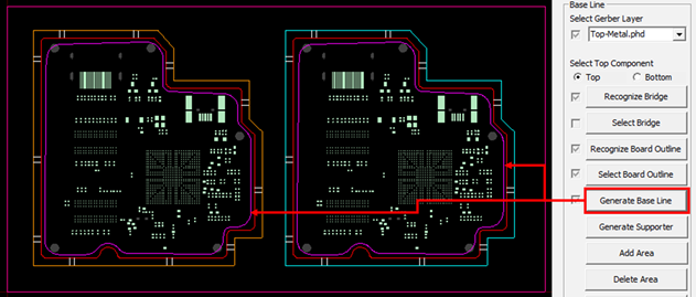

Generate Base Line: When you click Generate Base
Line, the base line is generated with purple. Figure 6.

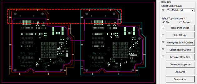

Generate Supporter: When you click Generate
Supporter, the support is generated in the area where the
components are not placed inside the base line. Figure 7.

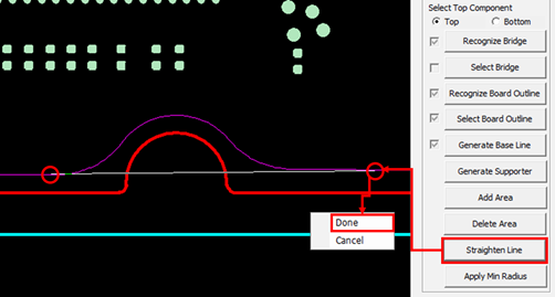

Straighten Line: To convert the created base line into a straight line,
click Straighten Line, click two points to be
straightened, and then click Done. Figure 12. Figure 13.
