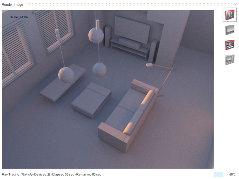

The Render in Darkroom window is displayed:
- To the bottom left of the current rendering, the status is displayed,
including information about the rendering engine, number of samples,
remaining time, and elapsed time.
- At the bottom right of the window, the current rendering is listed in
the queue.
