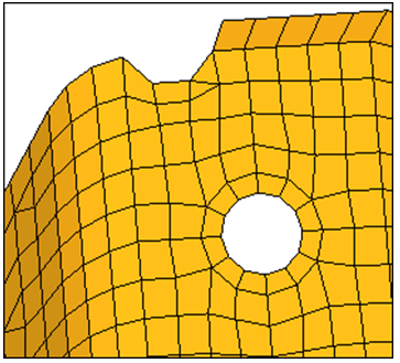

Modify and Optimize Element Quality
In this step you will modify the washer radius and optimize element quality by using Cleanup tools.
- From the 2D page, click qualityindex.
- Click cleanup tools.
- Click modify hole & washers.
- Clear the edit checkbox.
Select a node on the washer as indicated in the following image.
The radius field displays a value of 5.98.Figure 32.
- Select the edit checkbox.
- In the radius field, type 7.
- Select the link washers checkbox.
- Select the remesh number of layers checkbox, and then type 3 in the editable field.
Select a node on the washer as indicated in the previous image. The radius
changes to 7.
Note: Because you selected the link washers checkbox, the hole's radius will change accordingly (approx. 4.68). Due to the change in the hole's and washer's dimensions, elements around the washer will be distorted and will fail in quality. You can correct all of the failed elements in the model using the node optimize and element optimize cleanup tools.Figure 33.
- Click node optimize.
Select a few nodes on the elements that you modified in Step 9.
When you select a node, HyperMesh repositions it so that the elements attached to the node will have the best possible quality based on the criteria specified in the Quality Index panel.
- Click element optimize.
Select the red and yellow elements in the model.
When you select an element, HyperMesh adjusts it to have the best quality possible based on the criteria specified in the Quality Index panel.Figure 34.

- Under Selection, set the toggle to Width.
- Under Value, type 3.0.
- Select the Minimum number of nodes around the hole checkbox.
In the Density field, type 12.
Figure 38.
Click Add.
HyperMesh creates a washer around the hole.Figure 39.
