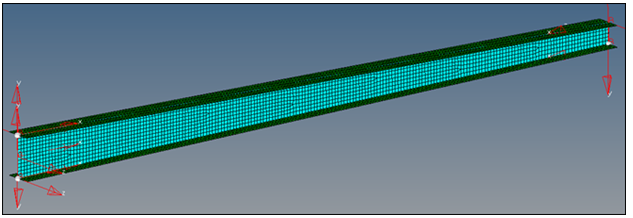

Create a Coordinate System
In this step you will create a coordinate system for spar2.
- Open HyperMesh Desktop.
- In the User Profiles dialog, set the user profile to OptiStruct.
- Open the model file, icw_ex1.hm.

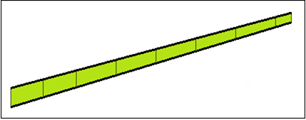

Open the Sets Browser by clicking Tools > Sets Browser from the menu bar.
Since you will be working with Spar2, you will need to display the elements which represent Spar2 in the graphics area. Element sets, in addition to components and assemblies, can be used as a model grouping and visualization tool. Elements sets can be created, deleted, made visible, and hidden using the Sets Browser.
In the Sets Browser, Elements folder, right-click on
Spar2 and select Isolate from
the context menu.
The elements representing Spar2 display in the graphics area.
Turn on element shading by clicking
(Shaded Elements and Mesh Lines) on the Visualization toolbar.

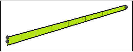

Figure 4. - Open the Nodes panel by clicking Geometry > Create > Nodes > Interpolate Nodes from the menu bar.
Using the node list selector, select the nodes on the top and bottom of the
left side.
Figure 5. -
Click create.
HyperMesh creates a node on the left end of Spar2.
- Repeat Step 1.8 and 1.9 to create a node on the right side of Spar2.
- Click return to exit the Nodes panel.

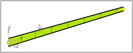

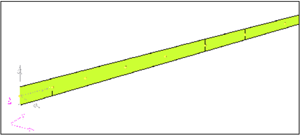

- From the menu bar, click Geometry > Create > Systems > Axis Direction.
- Go to the create by axis direction subpanel to create a system with origin at the left end and x-axis along the length of the spar.
- Using the origin selector, select the left-middle node.
- Using the x-axis selector, select the right-middle node for x-axis node.
Using the xy plane selector, select the left-top node for the xy-plane
node.
Figure 6. - Toggle to rectangular.
Click create.
Figure 7. - Click return to exit the Systems panel.

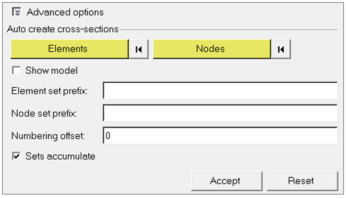

In the FDB Cross-Section Manager tab, click the arrow next to
Advanced options to display the Auto create
cross-section form. Use this form to create cross-sections along the length of
Spar2.
Resultant force and moment extractions will be performed on these cross-sections to obtain the necessary data to generate shear moment diagrams and potato plots. There are two options to define cross-sections: a manual method and an advanced method. The advanced method automates the creation of "continuous" cross-sections. The advanced method will be used in this tutorial. See the online help for details about the manual method.
Figure 8. - Click Elements twice.
- In the panel area, click elems >> by sets.
- Select Spar2.
Click select.
Figure 9. - Click proceed.
- In the FBD Cross-Section Manager tab, click Nodes twice.
- Select the left-top and left-bottom nodes which define the first cross-section for Spar2.
- Click proceed.
- In the Element set prefix field, type Spar2_E.
In the Node set prefix, type Spar2_N.
Since the cross-section manager utility creates the necessary element and node sets, you must define a prefix string for both element and node sets. This string will be appended by an incremental number to give each created set a unique name. Optional input includes numbering offset which defines an initial number for which the appended set numbers will begin.
- Verify that the Sets accumulate checkbox is selected.
Click Accept.

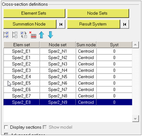

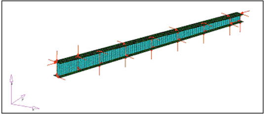

A spreadsheet populates with the definitions of the cross-sections generated by the Auto create cross-sections utility.
Figure 10. -
Select the Display sections checkbox, and then select
any section in the spreadsheet to review the selected cross-section.
The graphics area will be updated with the element set, node set, sum node, and result system that define the selected cross-section. Optionally, if you select the Show model checkbox, the entire model will be visible in the graphics area with the selected cross-section highlighted in red and the remainder of the model transparent.
- Select the first cross-section in the spreadsheet (Spar2_E1; Spar2_N1), hold Shift, and select the last cross-section (Spar2_E8; Spar2_N9) to select the cross-sections for updating their result system.
- Update any single or multiple cross-sections by selecting the cross-sections from the spreadsheet using Ctrl/Shift and then selecting Summation Node or Result System to update these definitions for all selected cross-sections.
- Click Result System twice.
- Select the system located at the left-middle end of Spar2 (system 102 created in Step 1).
Click proceed.
Note: You may have to display the Longeron2 system collector from the Model Browser (Model tab) to display system 102.All cross-sections update to result system 102. Note that system 102 has the x-axis along the length of the spar, y-axis located at the neutral axis of the beam in the plane of the web, and z-axis perpendicular to the web of the beam. Also note that the sum node is set to the default centroid, which automatically calculates the centroid of each cross-section and at which the resulting resultant force and moment calculations will be performed. The result system is the system for which all resultant force and moment result vectors will be transformed into and output.
Figure 11. - Close the FBD Cross-Section Manager utility.

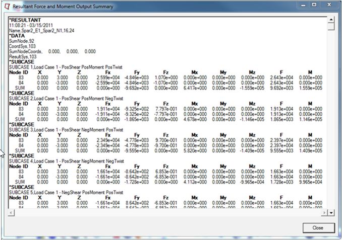

Resultant force and moment calculations are executed on all of the selected cross-sections for all selected subcases.
The Resultant Force and Moment Output Summary tab displays the resultant force and moment calculations (see the following image). For each cross-section, there is a separate data block grouped by loadstep. The data block contains cross-section nodal forces, moments, and the sum of those nodal forces and moments about the defined sum node, in this case the calculated centroid of the cross-section.
Note that the sum of the moment components (Mx, My, Mz) for each node is not the direct sum, as the (rXF) terms for the force resultant vector about the sum node must also be added to each moment component appropriately. The sum of the forces components (Fx, Fy, Fz) for each node is, however, the simple sum.

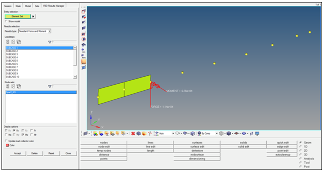

- From the menu bar, select Post > Free Body Results Manager to open the FBD Results Manager tab.
- Click Element Set twice.
- Click set and then select Spar2_E2.
- Click proceed.
- In the FDB Results Manager window, activate the Show model check box to display the entire model with the selected element set highlighted in red and all other elements transparent. This feature will help you easily locate the element set within the model.
For Results type, select Resultant Force and
Moment.
This operation scans the database for available loadsteps with resultant force and moment results and populates the Loadsteps: list box.
For Loadsteps, select SUBCASE1.
This operation scans the database for available node sets with resultant force and moment results and populates the Node sets: list box.
For Nodes sets, select Spar2_N3.
This operation will scan the database for available force and moment vector results and will enable the check boxes for those force and moment vectors which are available.
For Display options, select Fy (shear—the results
coordinate system had y-axis in the plane of the web) and
Mz (principal bending moment—the results coordinate
system had z-axis perpendicular to the plane of the web).
To determine the result coordinate system applied to a given cross-section of interest, use the FBD Cross-Section Manager to review the defined cross-section. This operation will show the element set, node set, results system, and sum node defined for the selected cross-section. Optionally, select other force components to review their magnitude and direction in the graphics area. Single or multiple force and moment vector results can be displayed in the graphics area to facilitate data mining and reporting.
- Optional:
Select Update load collector color and select
color to change the color of the selected load
vectors.
The new color setting applies only to the load components selected and is saved in the database. Therefore, this option can be used to recolor any single or multiple load vectors for any FBD result.
- Click Accept to visualize the resultant force and moment vectors in the graphics area.

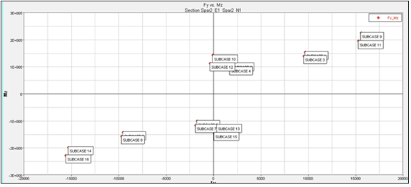

Generate Potato Plots
In this step you will generate potato plots for Spar2 for selected cross-sections.
Click the Add Page button (
) to create a new page.
- On the toolbar, use the pull-down menu to switch to the HyperGraph 2D client.
- From the menu bar, select Tools > Free Body Diagrams > Potato Plot to open the Potato Plot dialog.
Click fbd file (
) to load the file, icw_res_force_moment.fbd.
The available cross-sections and loadstpes within the.fbd
file are loaded into the form. -
From the Sections list, select cross-section
Spar2_E1_Spar2_N1 as the cross-section for which to
generate potato plots.
Potato plots generate a single plot for each selected cross-section which contains data points for all selected loadsteps Potato plots effectively "take a slice" through shear moment diagrams at a given cross-section for all selected loadsteps. Since Spar2_E1_Spar2_N1 is the wing root section for Spar2, it will be the largest loaded section and hence can be utilized to determine the critical loadsteps for Spar2.
Potato plots can facilitate critical loadstep determination by identifying maximum and minimum loads on given cross-section. In this case, you are going to be interested in identifying maximum and minimum shear and moment forces, Fy and Mz, respectively. There are other methods for determining critical loadsteps and standard practices and methods should be examined and utilized.
- From the Loadsteps list, select all loadsteps using filter buttons next to the list box or by using Ctrl + Shift.
- On the Potato Plots tab, for the X component, select Fy (shear).
- For the Y component, select Mz (principal bending moment).
Click Add plot.
Note: You can add additional potato plots by selecting alternative X and Y components and clicking Add Plot. You can also delete defined plots by selecting the plots from the spreadsheet area and clicking Delete Plots.
- Optional: On the Plot Titles tab, type a Title and Subtitle.
- On the Plot Options tab, for Reverse sign, select cross-section Spar2_E1_Spar2_N1 in the top drop-down list.
Select Reverse selected section in the bottom drop-down
list.
The explanation for the reverse cross-section options is discussed in Step 6.11.
- Activate the Label points: Loadstep checkbox.
Click Apply to generate the
requested potato plots.
Since one cross-section was selected, one plot will be generated (one for each cross-section). Potato plots are typically used to determine the loadsteps from which maximum/minimum behavior occurs. From the resulting potato plot of cross-section Spar2_E1_Spar2_N1 it can be determined that maximum/minimum loadsteps for shear and moment are SUBCASES 9, 11, 14, and 16.These critical loadsteps will be considered in future submodeling procedures as a subset of all the loadsteps used to design the spar. FBD forces will be extracted from these loadsteps in Exercise #2 and applied to a detailed model of Spar2 so that FBD analysis and design of the spar can be performed.
Figure 15.

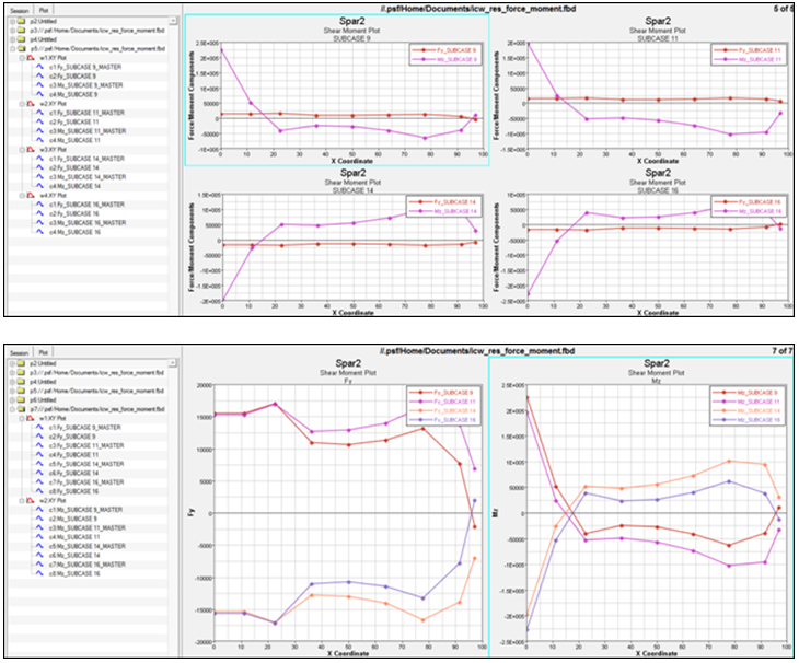

Generate Shear Moment Diagrams
In this step you will generate shear moment diagrams for Spar2 for selected subcases.
Click the Add Page (
) button to create a new page.
- From the menu bar, select Tools > Free Body Diagrams > Shear Moment Plot to open the Shear Moment Plot panel.
Click fbd file (
The available cross-sections and loadsteps within the .fbd file are loaded into the form. - From the Sections list, select all sections related to Spar2 (Spar2_E1_Spar_N1 through Spar2_E8_Spar2_N9) using filter buttons next to the list box or by using Ctrl + Shift.
- From the Loadsteps list, select SUBCASE 9, SUBCASE 11, SUBCASE 14, and SUBCASE 16, which are the critical loadsteps determined in Step 6.5.
On the VMT Plots tab, for X component select X. The (X)
X component is selected because the resultant force and moment extraction
coordinate system was performed with coordinate system 102 which has the x-axis
along the length of the Spar.
Options for X component include X, Y, or Z coordinates as defined from the coordinate system selected to perform the resultant force and moment extraction (Step 3, part 6).
On the VMT Plots tab, for Y component select Fy and
Mz to plot the shear and principal bending moment for
Spar2.
To determine the result coordinate system applied to a given cross-section of interest, use FBD Cross-Section Manager to review the defined cross-section. This operation will show the element set, node set, results system, and sum node defined for the selected cross-section and can help in identifying which components of force or moment are required for the desired plot.
list.
The option allows for methods to reverse the sign of the results from any single or multiple cross-sections. The option is useful since, for this particular plot, all cross-sections were defined coming from the right. However, the first section [Spar2_E1_Spar2_N1], since it has no elements to the left of this cross-section, can only be defined from the left.
Cross-sections, defined by the nodes and elements within their respective sets, can be defined coming from the left or right depending on the elements chosen for any given nodal cross-section definition. Therefore, any given cross-section can be defined from the left or from the right.
The only difference in the results defined either way is that the results will be opposite in sign but equal in magnitude. Either way, for a shear moment diagram, it is important that all selected cross-sections be defined coming from the same direction so that the resulting plot is valid.
Verify that the Envelop results checkbox is
deactivated.
Note: If you only want the maximum/minimum selected Y components to be plotted from all selected loadsteps for each cross-section, activate the envelop check box. For this tutorial, do not activate this check box.
For Layout, select the layout of plots desired.
This option affects the number of resulting plots that will be generated. The options are: One plot per loadstep, One plot per Y Component, and One curve per plot. The total number of curves that are generated is always (Curves = number or loadsteps * number of Y components). In this example, since you selected four loadsteps and two Y components, there are a total of eight curves that will be extracted. The number of plots that these eight curves will be displayed on depends on the layout selection.
With the option One Plot per loadstep, there are four plots since there are four loadsteps; each plot with both selected Y components, or in this case shear and moment on a single plot for each loadstep. The results of this layout option are shown in first picture, following.
With the option, One Plot per Y component, there are two plots since there are two Y components, each plot with all four selected loadsteps, or in this case shear on one plot and moment on another plot for all four selected loadsteps. The results of this layout option are shown in the second picture, following. Try both options.
shear moment plots.
These plots can be used with traditional mechanics of materials calculations such as S = My/I and T = VQ/IT to calculate stresses for various cross-sections. The plots provide the M (bending or Mz) and V (shear or Fy) values to these equations which when coupled with cross-section properties which can be calculated using HyperBeam (from the main menu, select the 1D page, then select HyperBeam), allows for the calculation of the cross-section stresses.

Elements that represent Spar2 are now displayed in the graphics area. To turn on element shading, click Shaded Elements and Mesh Lines (
The graphic area is updated with all systems in the model.
in Exercise 1, Step 1), and click proceed.
Note: You may have to display the Longeron2 system collector from the Model Browser to display system 102.The result system is the system for which all free body force and moment result vectors will be transformed into and output.
Figure 17. -
Click Summation Node twice, select the left-bottom node,
and then click proceed.
This summation node is the node for which all free body force and moment vector results will be summed about to generate a single equivalent resultant force and moment vector. Note that for a free body (all loads), the summation about any point must be zero. Therefore, this feature is typically used to verify that the extraction produced a free body with zero summation. However, if a free body other than (all loads) is performed, the selection of the summation node can be used to determine the equivalent resultant force and moment vector for the extracted free body (applied load only or reaction loads only) which in general will not be zero and can be of interest.
Figure 18. -

Click Accept to execute the FBD forces calculations for
The FBD Forces Output Summary window displays the FBD forces calculations. See following image. There is a separate data block grouped by loadstep. The data block contains free body nodal forces, moments, and the sum of those nodal forces and moments about the defined sum node.
Note that the sum of the moment components (Mx, My, Mz) for each node is not the direct sum as the (rXF) terms for the force resultant vector about the sum node must also be added to each moment component appropriately. The sum of the forces components (Fx, Fy, Fz) for each node is, however, the simple sum.
In addition, the sum for a Free Body – All Loads result should be, and is, zero about any sum node selected. You can verify this with the SUM line at the bottom of each data block. For other FBD types; however, the sum about the sum node may or may not be zero, depending on the selections.
Figure 19. - Optional: Open the icw_fbd_forces.csv file directly with Microsoft Excel by double-clicking the file in Windows Explorer. This file contains the same results as the summary table in the previous image, but is available for import into standard spreadsheet or text editor programs.

In this step you will use the FBD Results Manager to review FBD force vectors in the graphics area.
- Click set, then check Spar2.
- Click select.
- Click proceed.
- Optional: Activate the Show model checkbox to display the entire model with the selected element set highlighted in red and all other elements transparent. This feature will help you easily locate the element set within the model.
For Results type, select FBD Forces - All Loads.
This operation scans the database for available loadsteps with FBD Forces – All Loads results and populates the Loadsteps list box.
For Loadsteps, select SUBCASE 9.
This operation will scan the database for available force and moment vector results and will enable the check boxes for those force and moment vectors that are available.
For Display options, select Fy (shear – the results
coordinate system had y-axis in the plane of the web.)
To determine the result coordinate system applied to a given cross-section of interest, use FBD Cross-Section Manager to review the defined cross-section. This operation will show the element set, node set, results system, and sum node defined for the selected cross-section.
Optionally, select other force components to review their magnitude and direction in the graphics area. Single or multiple force and moment vector results can be displayed in the graphics area to facilitate data mining and reporting. - Optional:
vectors.
The new color setting applies only to the load components selected and are saved in the database. Therefore, this option can be used to recolor any single or multiple load vectors for any FBD result.
- Click Accept to make visible the FBD force vectors in the graphics area.
- Optional: Continue to review FBD Forces - All Load vector results following Steps 6 through 13 for additional loadsteps and force/moment components.
- Click Reset to clear the display and reset the form.
Click Close to exit the FBD Results Manager
utility.
Figure 20.

Select the three nodes highlighted in the following image.
Figure 21. - Click system.
Select system 102 on left-middle end (x-axis
along length, y-axis along web, z-axis normal to web).
