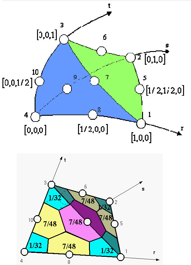

10-Node Solid Tetrahedron
The Radioss solid tetrahedron element is a 10 nodes element with 4 integration points and a quadratic shape function as shown in Figure 1.
Figure 1. (a) Isoparametric 10 Node Tetrahedron; (b) Nodal Mass Distribution
Introducing volume coordinates in an isoparametric frame:
L 1 = r
L 2 = s
L 3 = t
L 4 = 1 − L 1 − L 2 − L 3
The shape functions are expressed by:(1) Φ 1 = ( 2 L 1 − 1 ) L 1 (2) Φ 2 = ( 2 L 2 − 1 ) L 2 (3) Φ 3 = ( 2 L 3 − 1 ) L 3 (4) Φ 4 = ( 2 L 4 − 1 ) L 4 (5) Φ 5 = 4 L 1 L 2 (6) Φ 6 = 4 L 2 L 3 (7) Φ 7 = 4 L 3 L 1 (8) Φ 8 = 4 L 1 L 4 (9) Φ 9 = 4 L 2 L 4 (10) Φ 10 = 4 L 3 L 4
Location of the 4 integration points is expressed by 1.
  L 1 MathType@MTEF@5@5@+= feaagKart1ev2aaatCvAUfeBSjuyZL2yd9gzLbvyNv2CaerbuLwBLn hiov2DGi1BTfMBaeXatLxBI9gBaerbd9wDYLwzYbItLDharqqtubsr 4rNCHbGeaGqiVu0Je9sqqrpepC0xbbL8F4rqqrFfpeea0xe9Lq=Jc9 vqaqpepm0xbba9pwe9Q8fs0=yqaqpepae9pg0FirpepeKkFr0xfr=x fr=xb9adbaqaaeGaciGaaiaabeqaamaabaabaaGcbaGaamitamaaBa aaleaacaaIXaaabeaaaaa@37AE@ L 2 MathType@MTEF@5@5@+= feaagKart1ev2aaatCvAUfeBSjuyZL2yd9gzLbvyNv2CaerbuLwBLn hiov2DGi1BTfMBaeXatLxBI9gBaerbd9wDYLwzYbItLDharqqtubsr 4rNCHbGeaGqiVu0Je9sqqrpepC0xbbL8F4rqqrFfpeea0xe9Lq=Jc9 vqaqpepm0xbba9pwe9Q8fs0=yqaqpepae9pg0FirpepeKkFr0xfr=x fr=xb9adbaqaaeGaciGaaiaabeqaamaabaabaaGcbaGaamitamaaBa aaleaacaaIXaaabeaaaaa@37AE@ L 3 MathType@MTEF@5@5@+= feaagKart1ev2aaatCvAUfeBSjuyZL2yd9gzLbvyNv2CaerbuLwBLn hiov2DGi1BTfMBaeXatLxBI9gBaerbd9wDYLwzYbItLDharqqtubsr 4rNCHbGeaGqiVu0Je9sqqrpepC0xbbL8F4rqqrFfpeea0xe9Lq=Jc9 vqaqpepm0xbba9pwe9Q8fs0=yqaqpepae9pg0FirpepeKkFr0xfr=x fr=xb9adbaqaaeGaciGaaiaabeqaamaabaabaaGcbaGaamitamaaBa aaleaacaaIXaaabeaaaaa@37AE@ L 4 MathType@MTEF@5@5@+= feaagKart1ev2aaatCvAUfeBSjuyZL2yd9gzLbvyNv2CaerbuLwBLn hiov2DGi1BTfMBaeXatLxBI9gBaerbd9wDYLwzYbItLDharqqtubsr 4rNCHbGeaGqiVu0Je9sqqrpepC0xbbL8F4rqqrFfpeea0xe9Lq=Jc9 vqaqpepm0xbba9pwe9Q8fs0=yqaqpepae9pg0FirpepeKkFr0xfr=x fr=xb9adbaqaaeGaciGaaiaabeqaamaabaabaaGcbaGaamitamaaBa aaleaacaaIXaaabeaaaaa@37AE@
a α β β β
b β α β β
c β β α β
d β β β α
With,
α = 0 ⋅ 58541020 and β = 0 ⋅ 13819660 .
a, b, c, and d are the 4 integration points.

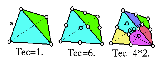

CPU Cost and Time/Element/Cycle
The CPU cost is shown in Figure 5:
Figure 5. CPU Cost in TEC

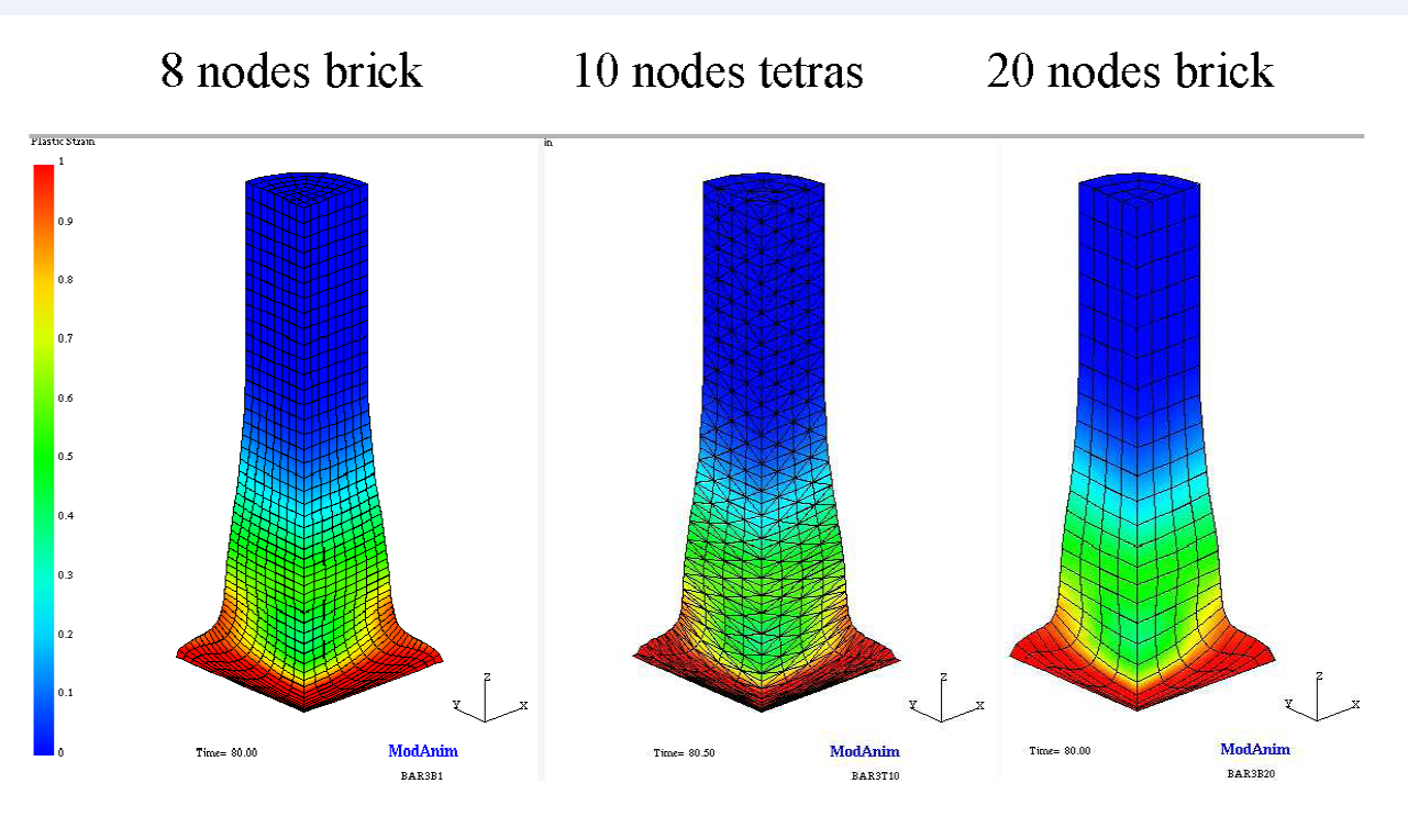

Example: Comparison
Below is a comparison of the 3 types of elements (8-nodes brick, 10-nodes tetra and 20-nodes brick). The results are shown in Figure 6 for a plastic strain contour.
Figure 6. Comparison (plastic strain max = 60%)
