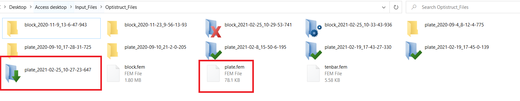

A job is submitted based on an input file having the name "file_name" in the format yyyy-mm-dd_hh-mm-ss. A directory called "file_name_yyyy-mm-dd_hh-mm-ss" is created in the same location as the input file.
Figure: Job Output Directory
