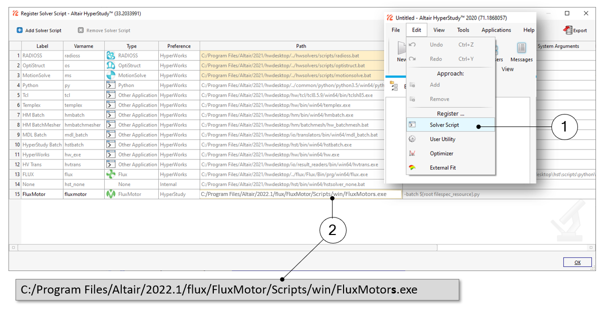

  7. Export environment – HyperStudy®
    • New solver script to be registered
      Before starting new studies in Altair® HyperStudy® by using connectors exported from Altair® FluxMotor®, FluxMotor® must be registered as a new solver script in HyperStudy®. This must be defined only while using the coupling for the first time
      Connection between Altair® FluxMotor® and Altair® HyperStudy®
      1 Open the area in HyperStudy® to register FluxMotor® 2022.1 script
      2
      Path where FluxMotors.exe must be selected to be registered as a new solver in HyperStudy®.
      Note: FluxMotors.exe with an “s” at the end of FluxMotors.
      This must be defined only when using the coupling for the first time.

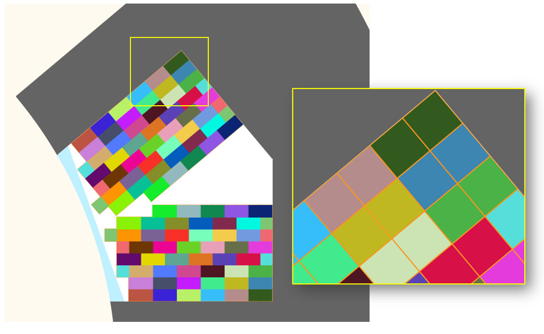

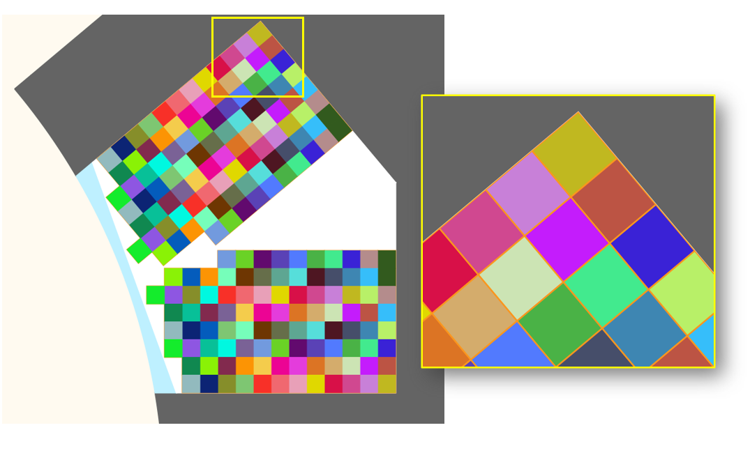

  8. Problems with slot filling
    1. The slot filling is not yet possible with a non-symmetric parallel slot.
    2. When a toothed winding design is considered with rectangular shape wires the conductor grouping method "horizontal" doesn’t work properly leading to wrong visualization of conductors. In that case, it is recommended to select the conductor grouping method "vertical".
      All works well with circular shape wires
      Example with a toothed winding design (i.e. the coil pitch = 1) and with 2 wires in hand.
    Horizontal filling – wrong visualization, but the total number of wires is right Vertical filling – good visualization
