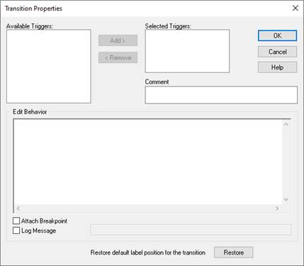

Attach Breakpoint: Sets a breakpoint the transition that causes the simulation to stop after the corresponding Embed time step is complete. For more information, see Using breakpoints.
Available Triggers: Lists all triggers within the scope of the transition.
Edit Behavior: Defines the transition specification. It can contain triggers, a BOOLEAN guard, and a behavioral expression. For more information, see Defining transition specifications.
Log Message: Logs the specified message when a transition behavior is executed. For more information, see Logging messages.
Restore: Repositions the transition specification label to its default location in the middle of the transition arc.
Selected Triggers: Lists the triggers associated with the transition.
