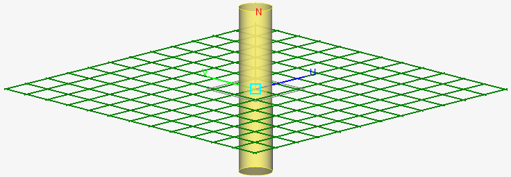

CADFEKO automatically adds a face on the split plane to keep the two split parts as solid parts.
Figure 1. The preview of the split operation on the thick dipole. - Union the two sections to ensure the faces in the edge port belong to the same part.
