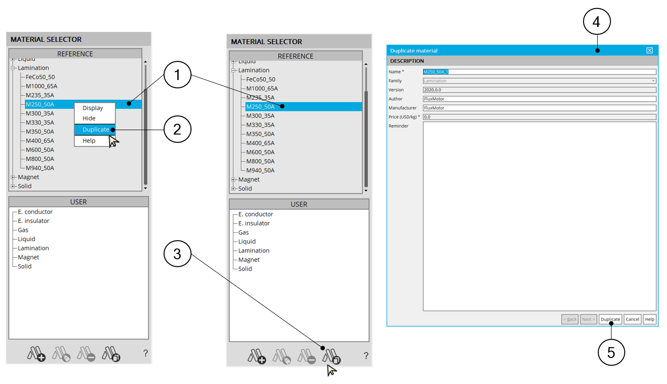

Here are the ways to duplicate a material:
| How to duplicate a material? | |
| 1 | In any case, one must select the name of the material to be duplicated. |
| 2 | The first way to duplicate a material consists of using the right mouse button to expand the corresponding menu and then clicking on the function Duplicate. |
| 3 | The second way to duplicate a material consists of clicking on the Duplicate button in the area where several functions are located at bottom part of the user material database to manage the materials. |
| 4 | A dedicated dialog box allows finalizing the creation of the new material from duplication by giving a new name and writing a memo if needed. |
| 5 | The creation of the new material is achieved when clicking on the Duplicate button.It is also possible to cancel the duplication. |
