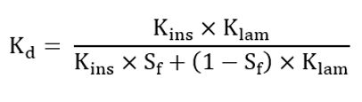

| Equivalent thermal conductivity in the lamination depth at Tref | W/K/m | |
| Specific heat at Tref | J/K/kg |
The user must define the magnetic characteristics of the solid material while the magnetic characteristics of the lamination stack are automatically deduced considering the value of the stacking factor.
See Advanced section: Create a B(H) curve.
| S f | Stacking factor |
| K ins | Thermal conductivity of the lamination insulation |
| K lam | Thermal conductivity in the lamination |
