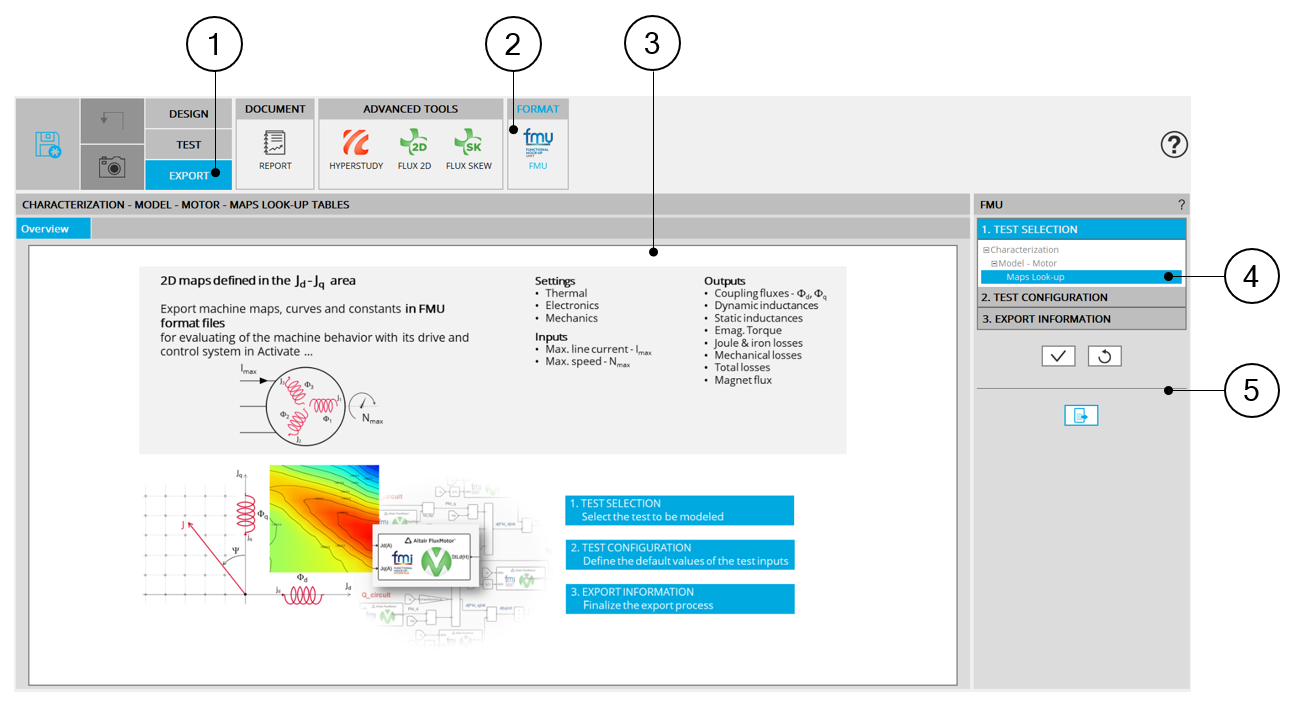

2. Area to export data in FMU format files
| Motor Factory – EXPORT AREA – Export data in FMU format files | |
| 1 | Selection of the EXPORT area of Motor Factory. |
| 2 | Access the area (FORMAT) in which data can be exported in FMU format files. |
| 3 | Zone to visualize either the overview of the selected test or the corresponding user inputs/outputs parameters |
| 4 | 3 steps to compute and to export data in FMU format files. |
| 5 | Buttons to validate inputs, display a preview and export the data. |
