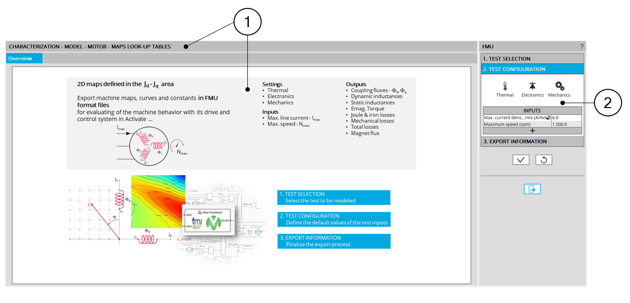

1.3 Test configuration
After selecting a test, the corresponding test inputs (settings and user inputs) must be defined. This allows to define the initial conditions for testing.
| Motor Factory – EXPORT AREA – FORMAT – FMU / Test configuration for Characterization / Model / Motor / Maps | |
| 1 | Overview of the selected test is displayed |
| 2 | User inputs can be defined in the test area. |

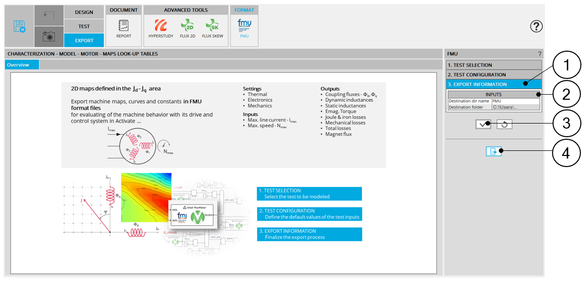

1.4 Export information
The last step for building and exporting data in FMU format files is to define the export information.
Two inputs must be defined:
- The name of the directory in which the created files will be stored
- The destination folder in which the previous directory will be located
| Motor Factory – EXPORT AREA – FORMAT – FMU / Export information | |
| 1 | Tab to be expanded to define export information. |
| 2 | Area in which the export information parameters to be defined are listed |
| 3 | Button to validate the previous choices |
| 4 | Button to finalize the export of the data files. One click opens the folder where the directory is located |
