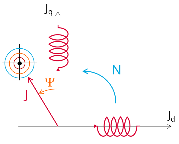

The aim of the test “ Working point – Sine wave – Motor – I, Ψ , N” is to characterize the behavior of the machine when operating at the targeted input values I, Ψ, N (Magnitude of current, Control angle, Speed).
Hence, these three inputs are sufficient to impose a precise working point.
The resulting model is fully parameterized, and it is built in Altair® Flux ® Skew environment, transient application.
| “Working point – Sine wave – Motor – I,Ψ, N” illustration |
