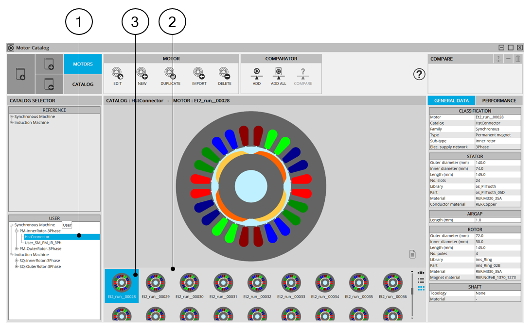

All the motors resulting from the runs performed with HyperStudy can be used back in Motor Catalog of FluxMotor® and then they can be edited in Motor Factory very quickly.
| Motor Catalog – Visualization of results got from HyperStudy® – Illustration for a synchronous machine | |
| 1 | A catalog is automatically built by using the name of the connector defined by the user |
| 2 | All the runs from HyperStudy® are stored in the dedicated catalog |
| 3 | Each motor can be selected, visualized and edited in Motor Factory to be evaluated more in depth |
