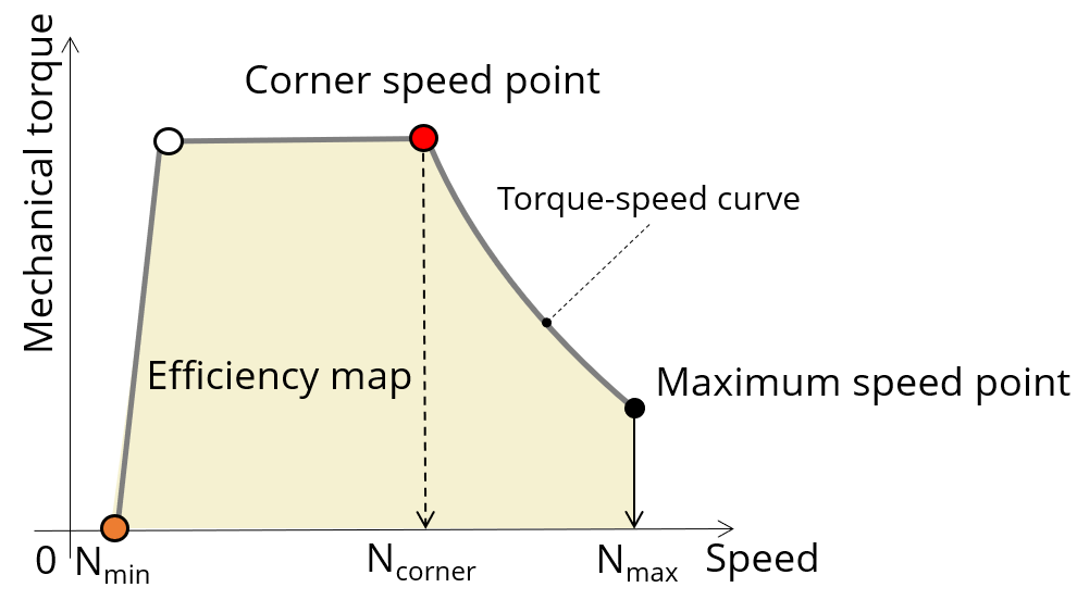

| Characterization of the corner speed point on the torque-speed curve |
In the results, the performance of the machine at the corner speed point and for the maximum speed set by the user are presented.

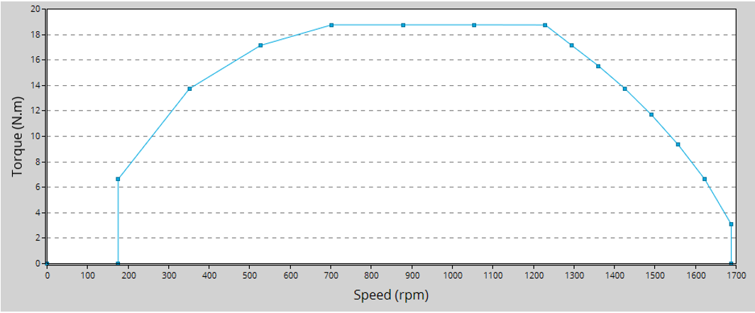

| Mechanical torque versus speed - Example |

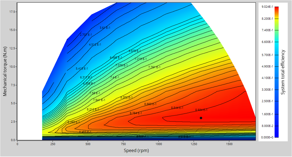

| Efficiency in torque-speed area - Example |

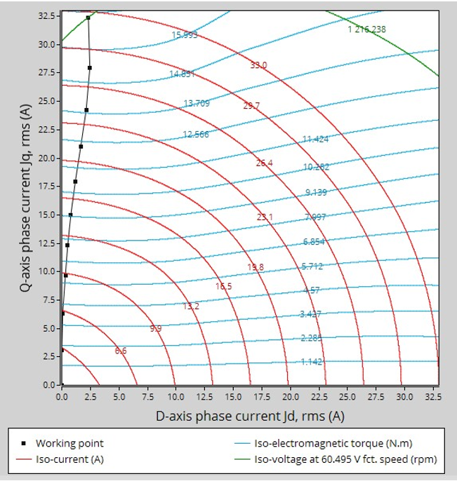

| Characteristics curves in J d -J q area - Example |

The first one allows extracting one point from the efficiency map to get the machine performance, for this specific working point (general data + power balance).
| A “single” working point displayed on the efficiency map - Example |

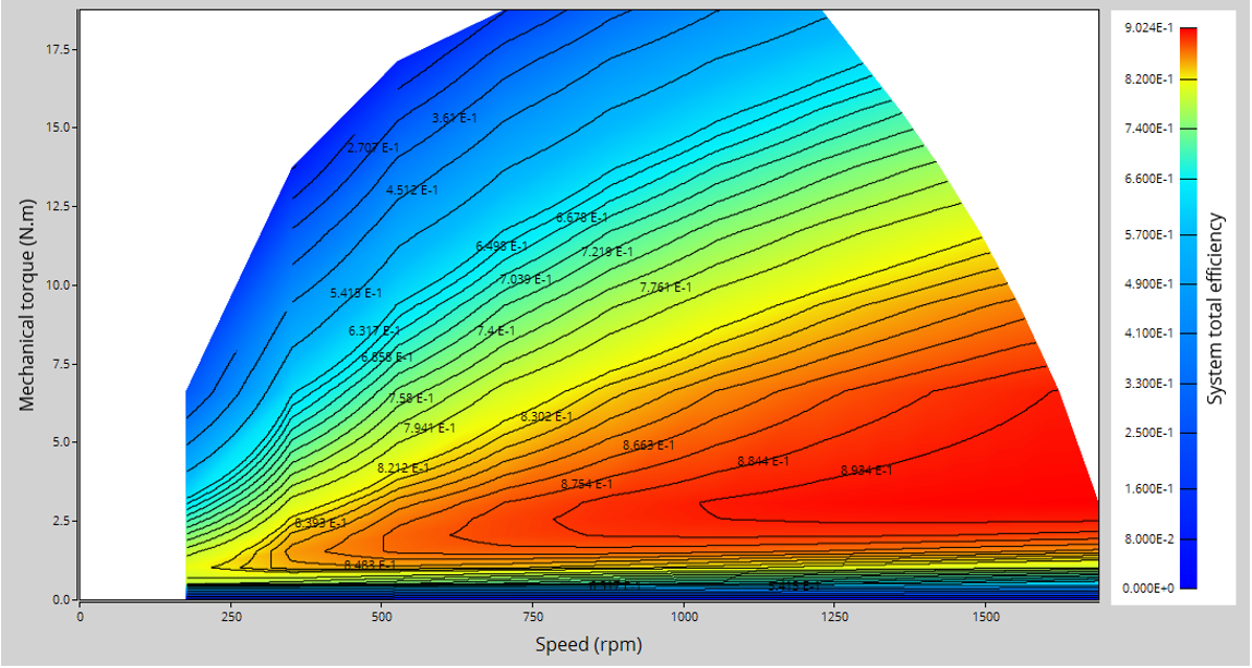

The second feature allows the user to define a duty cycle by giving a list of working points (speed, torque) versus the time. The displayed results illustrate the machine performance over the considered duty cycle (mean, min, and max values).
The time variation of the main quantities is also displayed (Mechanical torque, speed, control angle, current, voltage, power, efficiency, losses).
All the corresponding points are displayed on the provided maps.
| A “Duty cycle” displayed on the efficiency map - Example |
