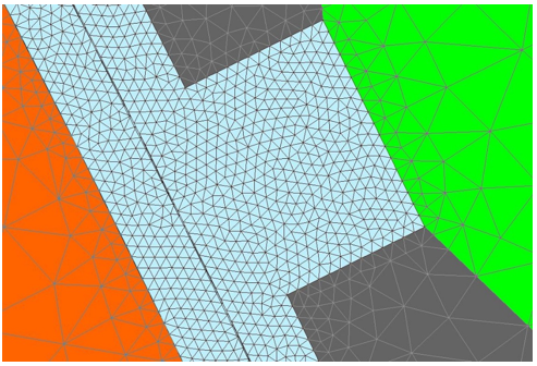

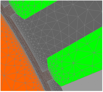

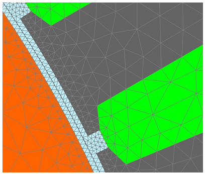

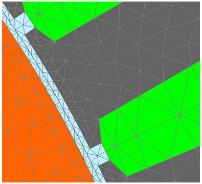

| Airgap mesh density = 0.45 = default value | Airgap mesh density = 1.0 |
| Airgap mesh density = 0.1 | Airgap mesh density = 0.1 (zoomed view) |
