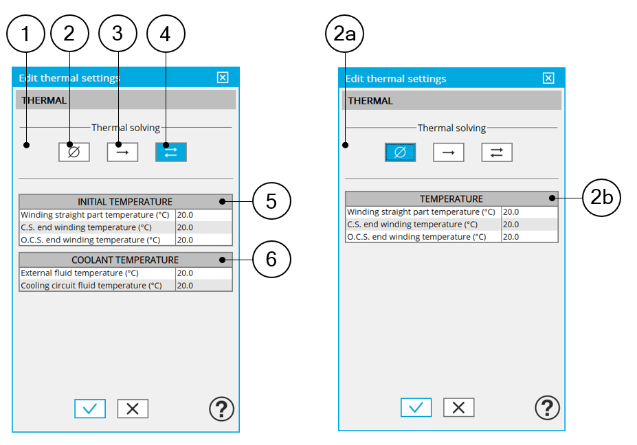

2. Thermal settings
In the thermal settings you have two main possible choices:
- Either you can define the temperatures of active components (Magnet and winding) to define the physical properties of the materials needed to run directly the tests without any thermal computation.
- Or you can choose between two other ways to run the test: iterative process until convergence or a single iteration process to perform electromagnetic computation coupled to thermal analysis.
| 1 | Dialog box to define the thermal settings.Buttons allow to choose one of the three thermal solving modes |
| 2 | The first option of thermal setting is to run the test with only electromagnetic computation without any thermal analysis. This option is the default one available for all the tests. |
| 2a | Dialog box that allows to define the machine active components winding and magnets temperatures to run test without any thermal analysis. |
| 2b | Temperatures of the machine active components to be considered for characterizing the physical properties of the associated materials. |
| 3 | Thermal solving mode with only one iteration between electromagnetic and thermal computations. |
| 4 | Thermal solving mode with iterative process between electromagnetic and thermal computations till the convergence. |
| 5 | Initial temperatures of the machine active components winding and magnets. These temperatures are used to initialize the electromagnetic-thermal process of computation. |
| 6 | Definition of coolant temperatures to be considered: · External fluid temperature (1) · Cooling circuit fluid inlet temperature (when a cooling circuit is defined on the design side (2) ) |
