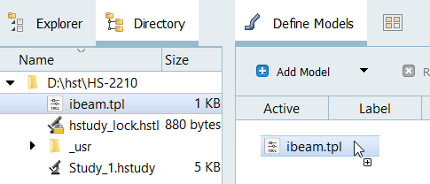

Add a Parameterized File model.
From the Directory, drag-and-drop the ibeam.tpl
file into the work area.
Figure 1. -

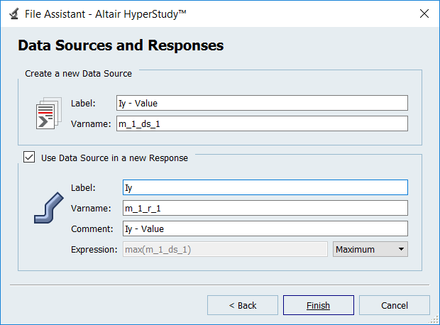

Create the Iy output response for the y-axis moment of inertia.
- From the Directory, drag-and-drop the output.hstp file, located in approaches/setup_1-def/run__00001/m_1, into the work area.
- In the File Assistant dialog, set the Reading technology to Altair® HyperWorks® and click Next.
- Select Single item in a time series, then click Next.
Define the following options, and then click
Next.
- Set Type to Output.
- Set Request to Iy.
- Set Component to Value.
Figure 2. - Label the output response Iy.
- Set Expression to Maximum.
Click Finish.
Figure 3.

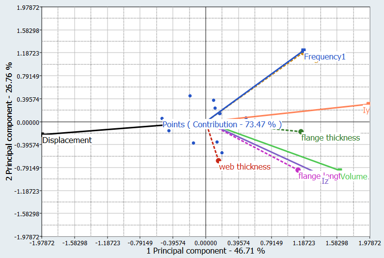

- Go to the DOE 1 > Post-Processing step.
Click the Ordination tab.
The biplot is interpreted by looking at the relationship between the lines that each represent one input variable or output response. The Displacement and Iy output responses show a strong negative correlation because they are aligned, but pointing in opposite directions. The displacement and Iy are also not at all correlated to the input variable web thickness, indicated by the orthogonality. Similar strong positive correlations are seen between the frequency and height or the volume, Iz, and flange length.
Figure 5.
