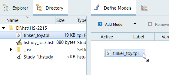

From the Directory, drag-and-drop the
tinker_toy.tpl file into the work area.
Figure 1. -

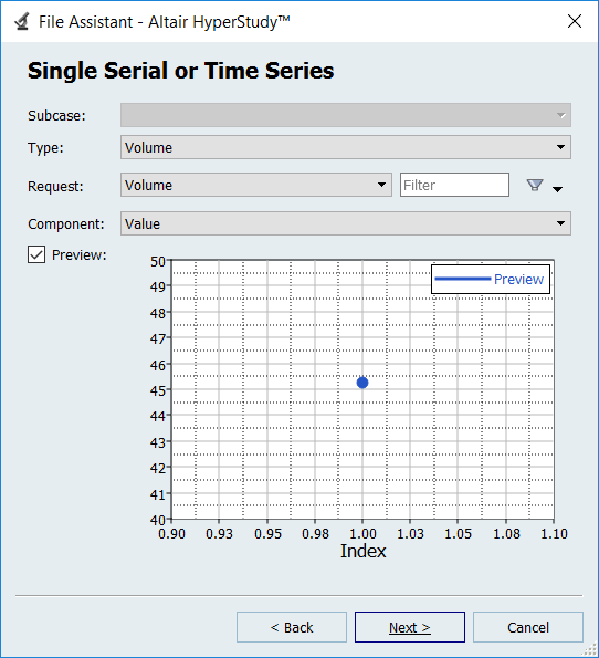

- In the File Assistant dialog, set the Reading technology to Altair® HyperWorks® and click Next.
- Select Single item in a time series, then click Next.
Define the following options, and then click
Next.
- Set Type to Volume.
- Set Request to Volume.
- Set Component to Value.

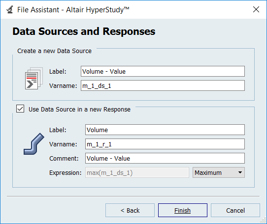

Figure 4. - Label the output response Volume.
- Set Expression to Maximum.
Click Finish.
Figure 5.

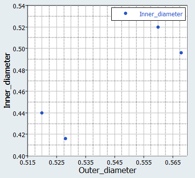

Click the Scatter tab, and using the Channel selector to
set the X Axis to Outer_diameter and the Y Axis to
Inner_diameter.
All four runs satisfy the constraint, which is inner_radius < outer_radius.
Figure 13. -

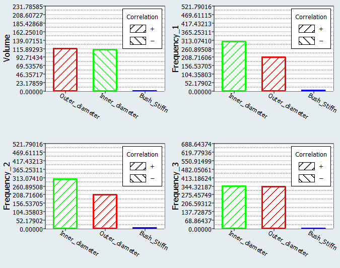

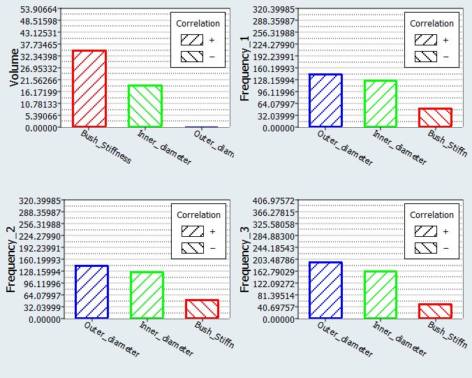

Review Pareto plot.
- Click the Pareto Plot tab.
- Above the Channel selector, click and verify that Multivariate effects is selected.
- Note which input variables contribute to which output responses.
Figure 14.

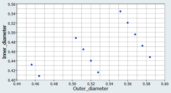

Click the Scatter tab, and use the Channel selector to
Inner_diameter.
All 11 runs still satisfy the constraint, which is inner_radius < outer_radius.
Figure 16. -
Click the Pareto Plot tab, and compare the results to
the Pareto Plot from DOE 1.
The magnitude and order of importance has changed in some cases.
Figure 17. Pareto Plot from DOE 2
Figure 18. Pareto Plot from DOE 1
the Pareto Plots from DOE 2.
The results are qualitatively the same, indicating that you will likely have enough runs to draw solid conclusions.
Figure 19. Pareto Plot from DOE 3
Figure 20. Pareto Plot from DOE 2
