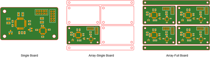

- Board Type: Select reading board type.
Figure 1.- Single Board: Use this option for reading single board.
- Array-Single Board: Use this option for reading array board contour and single board.
- Array-Full Board: Use this option for reading array board contour and full single board.

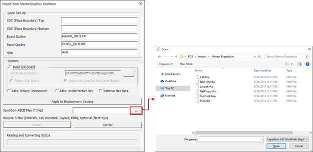

Mentor Graphics Xpedition
| File Name | Description |
| Cell.hkp | Component placement information |
| JobPrefs.hkp | Layer information |
| Layout.hkp | Routing information |
| NetProps.hkp | Net information |
| Padstack.hkp | Padstack information |
| PDB.hkp | Part library information |
