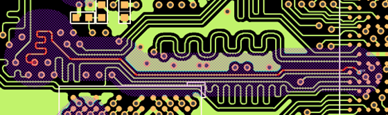

If there is an EMI problem, one of the methods to correct the problem is to shield with ground patterns. However, in most complicated designs, a perfect shielding is not easy to accomplish. Therefore, designers should carefully design grounds to achieve the best shielding effect not only for a single net but also for a differential pair net. Differential pair nets are employed to resolve SI noise, return path, PI, EMI issues that appear often in high speed signal nets. While differential pair nets take care of return path and impedance issues by themselves by being side-by-side with uniform distance apart, noise from other nets may disturb the differential pair nets, if they are not properly shielded, then prevent the paired nets do the intended roles. Therefore, it is important to shield the differential pair nets as much as possible. In order to shield signal nets or traces on the same layer, shielding grounds cover around the signal traces with a certain uniform clearance. However, for differential pair nets, shielding grounds should not present between the two pair nets. As a rule of thumb, it is recommended to shield at least 80 percent of signal net length. This item checks whether a design meets a specified shielding ratio.

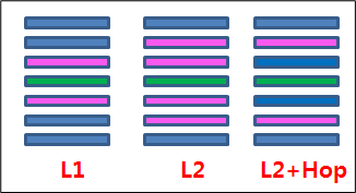

    • Check Layer:
    • L1 Layer: check one layer above and below.
    • L2 Layer: check two layers above and below.
    • L2-Hop Layer: check two layers one layer apart above and below.
      Figure 3. Layer definition

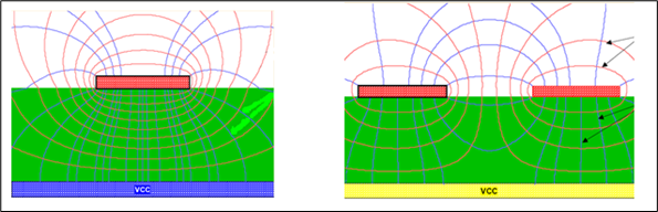

The flux radiated from each of differential signals are canceled each other because of their polarity is reverse. But it still needs ground shielding for better EMI and signal return.
Figure 4.
Although crosstalk noise on a differential pair has a significant common-mode component, it also has a differential component because the distance between an aggressor and each side of the pairs differs. Consequently, each leg will experience slightly different crosstalk, which will not be rejected by the differential amplifier. The signal swing of differential signal is so small this crosstalk can cause failure. Ground shielding is needed for differential lines.

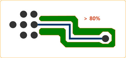

High speed signal’s 100 percent ground shielding is perfect, but it is impossible. Over 80 percent and shielding for all routed layers are recommended.
Figure 5.
