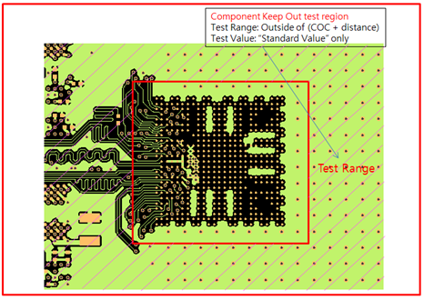

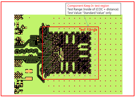

  • Component Keep IN/OUT: Define test region. For example, you can test inside or outside the breakout region of CPU with different test values.
    • Component Group: Select required component group which is used for defining the test region.
    • Region: Define the required test region.
      • IN: DFE tests the inside of the breakout region of target component.
      • OUT: DFE tests the outside of the breakout region of target component.
    • Range (COC+distance): Enter the distance value to define breakout range. The COC (Component Overlap Check) plus this distance value is considered the test range.

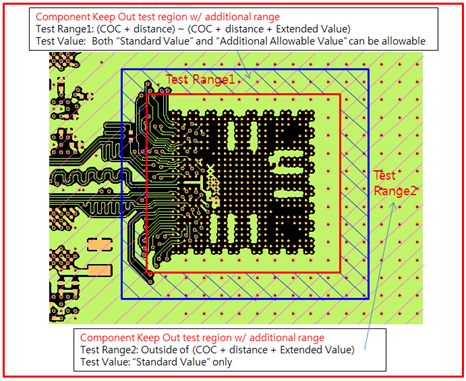

    • Different Rule Setup in Special Region: Assign additional test region for breakout region testing.
      • Extended Region from COC: Enter the distance value to define additional range. The COC (Component Overlap Check) plus this distance value is considered the additional test range.
      • Allowable Values: Assign additional allowable test value for this additional region. Click. The DFE Input Floating Point Value Setting dialog opens. You can assign multiple additional allowable values in this dialog.

    • The test range and test values will be:
      • Case1: Component Keep In region test
      • Case2: Component Keep Out region test
        Figure 3.
      • Case3: Component Keep Out with extended region test
        Figure 4.
