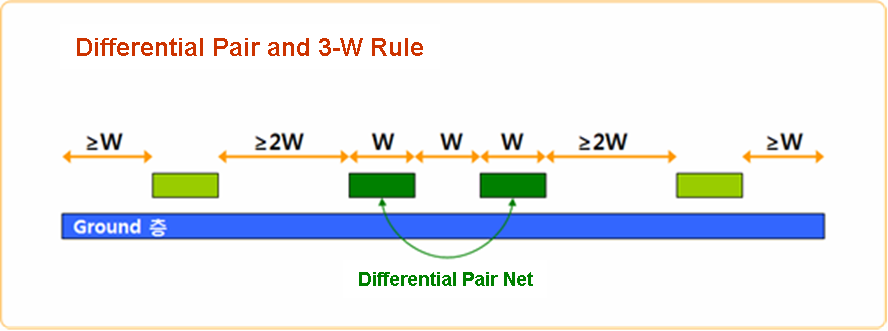

Differential pair nets are routing patterns with a certain parallel clearance apart on which reversed signals flow at the same time to send information.
Generally, two signals are represented as +/- or POS/NEG and keep sending stable signals. Differential pair nets are employed to resolve SI noise, return path, PI, EMI issues that appear often in high speed signal nets. Differential pair nets take care of return path and impedance issues by themselves by being side-by-side with uniform distance apart. For common signal trace, designers consider impedance at design stage. However, for differential pair nets, designers must consider coupled odd impedances. In other words, a differential pair net needs to be considered as one coupled signal pair. Generally, two signals are represented as +/- or POS/NEG and keep sending stable signals. Therefore, two signals must keep coupling status at design stage. This item checks the coupling status of paired signals. Near the component pins, due to the pin pitch, the distance may not be able to satisfy the differential pair distance criteria. The Pin Escape option is available to exclude a region near pin locations.

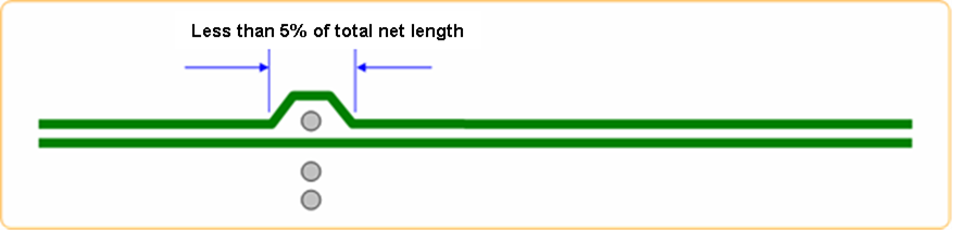

A Differential Pair Net usually keeps a minimum 80 percent of total net length parallel. The pair nets may be allowed to have a distance tolerance in parallelism when a net go around via or other objects on board. In this case, it is recommended to make those distance tolerances less than 5 percent.
