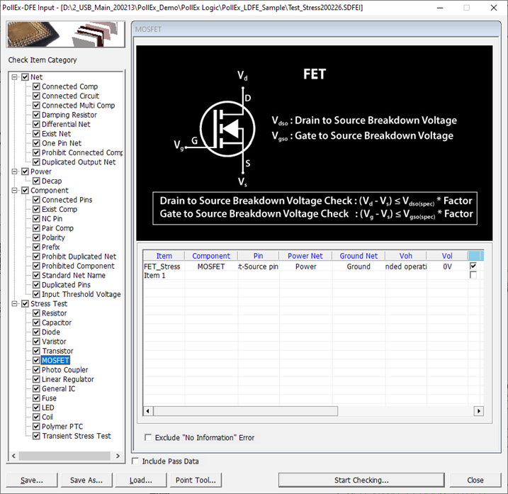

MOSFET
This item tracks the voltage and signal lines in the circuit, calculates the voltage value of each net, and checks whether all MOSFET connected to the net is within the allowable voltage range.
- Component: Select MOSFET component group to be checked.
- Pin: Assign pin
information of MOSFET. You can assign pin number using Pin Number or Pin
Property which contain pin number information.
Figure 2. - Power Net: Select power net group to which MOSFET components are connected.
- Ground Net: Select ground net group to which MOSFET components are connected.
- Voh: Set the output high voltage (Voh) of driver pin. You can set this by entering the value directly or select the property name which contain voh value.
- Vol: Set the output low voltage (Vol) of driver pin. You can set this by entering the value directly or select the property name which contain vol value.
- Vds Check: Set the
allowable Vds voltage of this component. You can set this by entering the
allowable value directly or select the property name which contain allowable
Vds value. You can also assign tolerance of this check.
Figure 3. - Vgs Check: Set the
allowable Vgs voltage of this component. You can set this by entering the
Vgs value. You can also assign tolerance of this check.
Figure 4.
