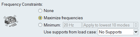

Select an option for Frequency Constraints.
| Option |
Description |
| Maximize Frequencies |
Select Maximize frequencies. (If you selected
Maximize Frequency as the optimization objective, this step is not
necessary.) |
| Minimum |
Select Minimum and enter the lowest frequency
you want to allow in the text field. Use the arrows in the scroll menu
to select the number of modes that you must exceed the minimum
frequency.

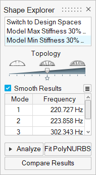

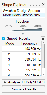

The Shape Explorer displays the frequencies
for the first six modes.
| Minimum Frequency Constraint |
for the modes that you selected.

- When maximizing stiffness, you may choose to either maximize
frequencies or set a specific minimum frequency. If you choose to
maximize frequencies, Inspire will
automatically maximize both the stiffness and frequency of the
model, and the lowest natural frequency will be displayed in the
Shape Explorer window. If the resulting frequency is not high enough

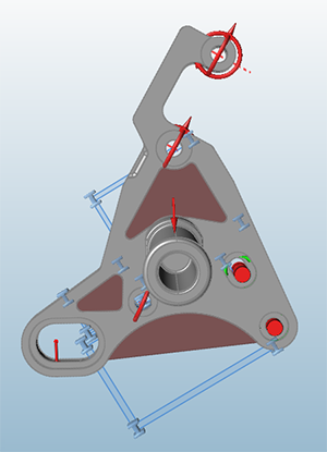

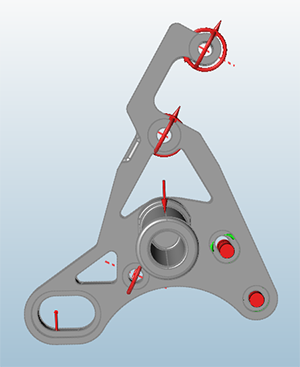

What If I'm Not Achieving My Frequency Constraint?
If your optimized shape is not achieving your desired frequency constraint, you may
need to add material to your part if running a topology optimization. In the example
below, the final part as designed was not achieving the required minimum frequency
of 500 Hz.
As a result, it was necessary to add three design spaces and apply an extrusion shape
control so that additional material could be added to meet the frequency
constraint.

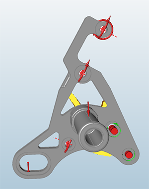

Then an optimization was run, with the objective to minimize mass. Only a frequency
constraint (no stress or displacement constraints) were applied. The image below
shows the resulting shape, with the additional material needed to meet the frequency
constraint displayed in yellow.
