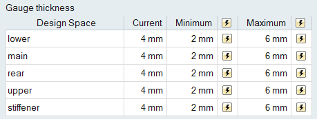

When running a gauge optimization, the gauge thickness is used to define the target Minimum and Maximum gauge thickness for each design space.

Change the Current gauge thickness for each design space
as desired.
- Define the target Minimum and Maximum gauge thickness for each design space.

- The current gauge thickness for each design space is displayed in the Run Optimization window, and can be defined here or in the Property Editor.
- The target Minimum and Maximum gauge thickness are defined by the user, and default to 20% above or below current gauge thickness.
