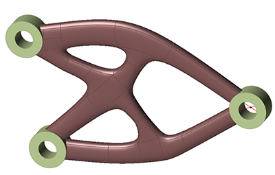

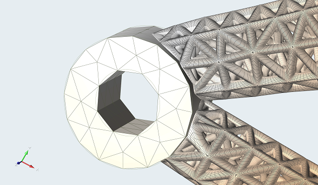

Figure 1. Design Space

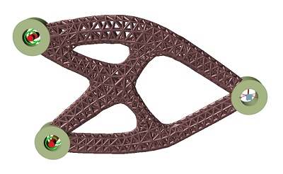

Figure 2. Optimized ShapeRunning a Lattice Optimization

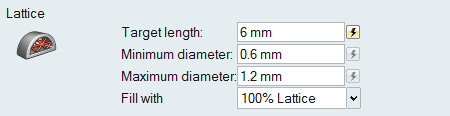

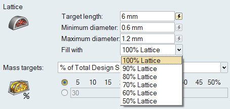

Lattice Dimensions
- Target length: The target length of a lattice beam.
- Minimum diameter: The minimum allowed diameter of a lattice beam.
- Maximum diameter: The maximum allowed diameter of a lattice beam.
The target length corresponds to the edge length of the parent solid element. When defining the minimum and maximum diameters of the lattice beams, both the practicalities of the geometry and the capabilities of the intended manufacturing process should be considered. With a length to diameter ratio of greater than 3, you start to produce a solid more voids rather than a true lattice structure.
Complete vs. Partial Lattice
Selecting a percentage less than 100% will result in a structure that is a mix of solid and lattice elements. In general, the results of this approach are often less aesthetically pleasing, with jagged or unusual results. Selecting 100% will fully convert the design space to an optimized lattice. This approach typically produces intuitive, aesthetically pleasing results with clean transitions between design and non-design regions.

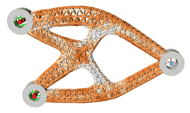

Figure 3. Lattice with Autocalculate Element Size On

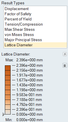

Lattice Diameter Result Type
Instead of the Shape Explorer, the Analysis Explorer is displayed at the end of a successful lattice optimization run.

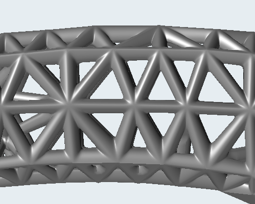

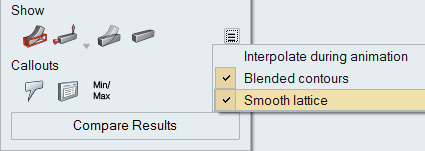

Smooth Lattice
You can create radii between the lattice beams to display a "smooth lattice" using
the Show options on the Analysis explorer.
Click the
button next to Show/Hide Contours icon and select
Smooth Lattice to create radii between the lattice
beams.

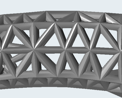

Figure 5. Smooth Lattice On
Figure 6. Smooth Lattice Off
