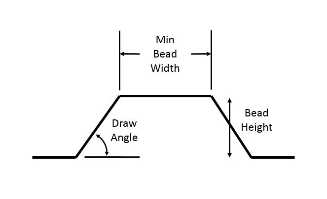

Bead options include the minimum bead with, the bead height (maximum depth), and the draw angle. Note that decreasing the bead width will increase the time it takes to run the optimization, as it will generate a more detailed optimization result. An important point is that you define a minimum bead width, not a required bead width. Therefore, the results of topography optimization with no manufacturing or symmetry constraints often show large areas of varying bead widths.

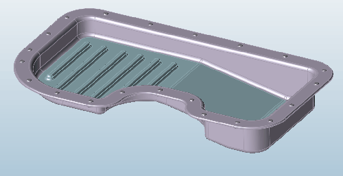

Typically, beads are very regular and are often simply aligned to major geometry features. Although they are well understood by manufacturers and do increase the stiffness of structures, topography optimization will usually result in a bead pattern that outperforms standard bead layouts.
Figure 3. Aligned Beads

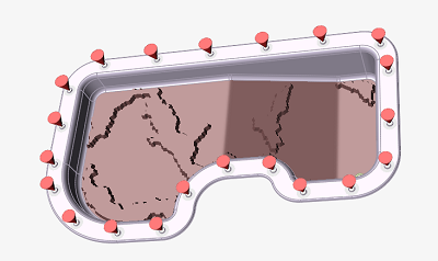

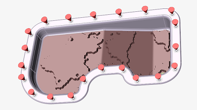

Bead Fraction

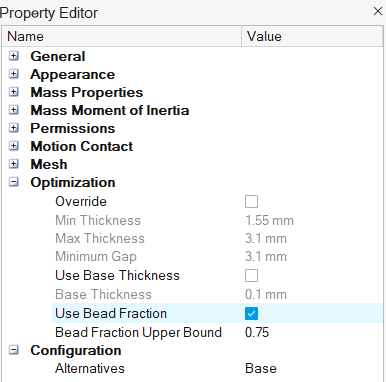

Select the Use Bead Fraction option in the Property Editor under Optimization to define a Bead Fraction Upper Bound.
Below you can see the difference when the bead fraction upper bound is set to 0.25 vs 0.75.
Bead fraction upper bound set to 0.25 |
Bead fraction upper bound is set to 0.75 |
