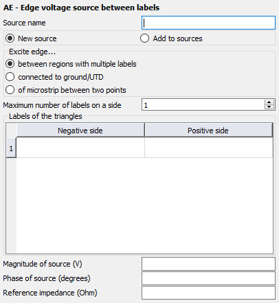

This card specifies an excitation at an edge between triangular surface elements.
On the Source/Load tab, in the Sources group,
click the
Voltage source
icon. From the drop-down list, click the
Voltage on edge (AE) icon.
Figure 1. The AE - Edge voltage source between labels dialog.
Figure 2. Example of the use of the AE card.
Parameters:
- New source
- A new excitation is defined which replaces all previously defined excitations.
- Add to sources
- A new excitation is defined which is added to the previously defined excitations.
- Excite edge
- This specifies how the edge is determined:
- Meshed surface represents positive feed side
- By default, the feed direction is such that the meshed surface represents the negative feed side. The vector direction of the current is then towards the UTD or ground. When this option is checked, the feed orientation is reversed.
- Magnitude of source (V)
- Magnitude value of the voltage source in V.
- Phase of source (degrees)
- Phase of the voltage source in degrees.
- Reference impedance (Ohm)
- The reference impedance of the excitation is used for S-parameter calculations and is the reference impedance used for realised gain calculations. It is also the default reference impedance used to calculate and display the reflection coefficient in POSTFEKO. If this field is empty or 0 in an S-parameter calculation, the value specified at the SP card is used. For realised gain and reflection coefficient calculations, 50 Ohm will be assumed when the field is empty or 0.
