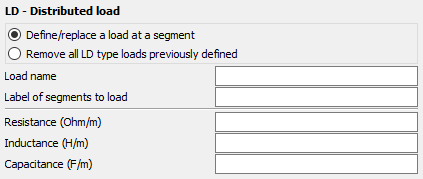

Figure 1. The LD - Distributed load dialog.
Parameters:
- Define/replace a load at a segment
- Define a load with the following parameters.
- Remove all LD type loads previously defined
- This LD card does not define a load, but rather all previously defined LD loads are deleted. All the other input parameters of this card are ignored.
- Load name
- The name of the load.
- Label of segments to load
- All segments with this label are subjected to distributed loading.
- Resistance:
- The distributed resistance in .
- Inductance
- The distributed inductance in .
- Capacitance
- The distributed capacitance in .
The combined impedance of the segment with length is then
It should be noted that if the Capacitance (F/m) is left empty, it is treated as infinite, so that it does not contribute to the impedance.
