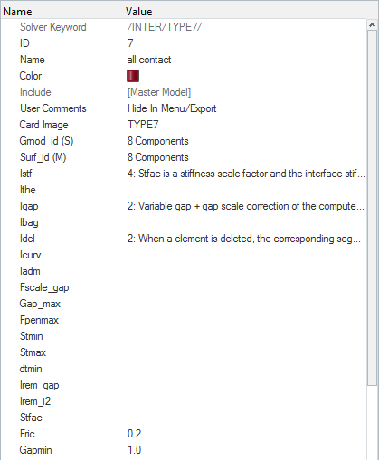

- /INTER/TYPE7: Penalty contact between all versus all

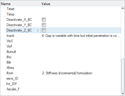

Create the Interface for Penalty Contact
