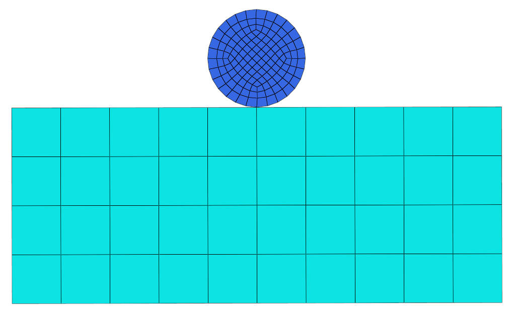

In HyperMesh, you can create contact pairs manually or with the Autocontact tool. The edge of the circular body acts as a Target (secondary) surface, and the top edge of the rectangular part acts as a contact (main) surface.

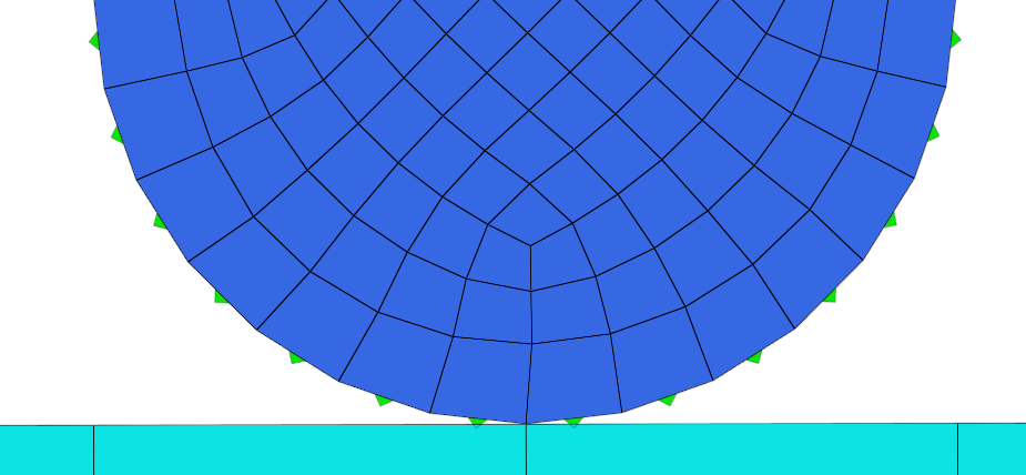

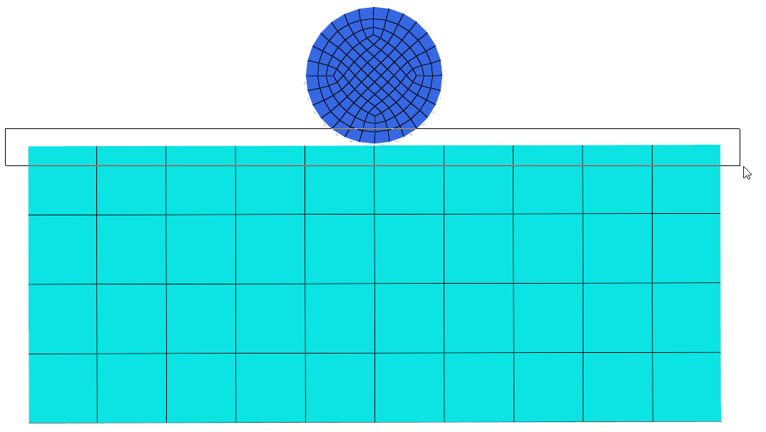

Create Target (Secondary) Surface
In this step, you will create a target surface in HyperMesh.

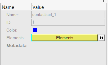

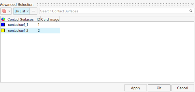

Create Contact (Main) Surface
In this step, you will create a contact surface in HyperMesh.

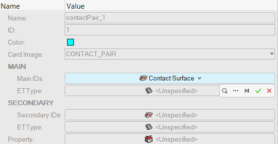

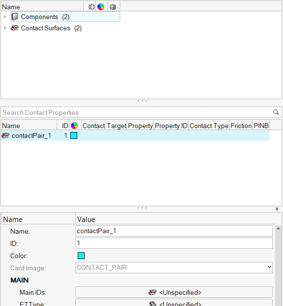

Create a Contact Pair
In this step, you will create a contact pair.

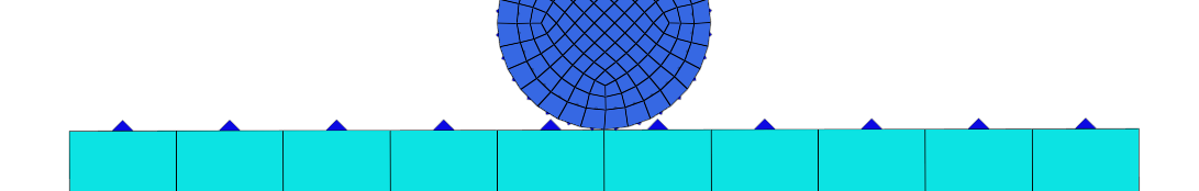

Review the Contact Pair
In this step, you will review the contact pair you created in step Create a Contact Pair.

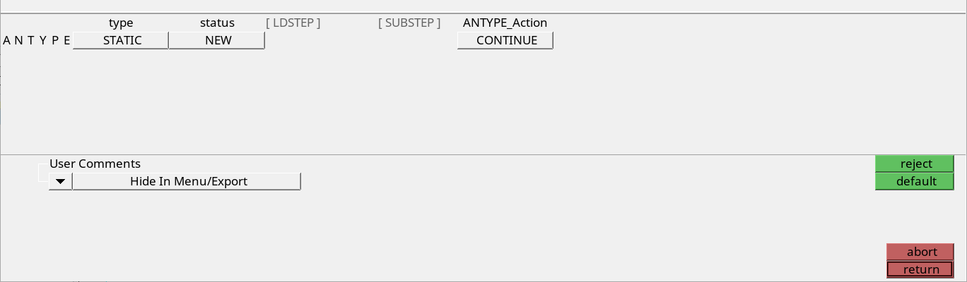

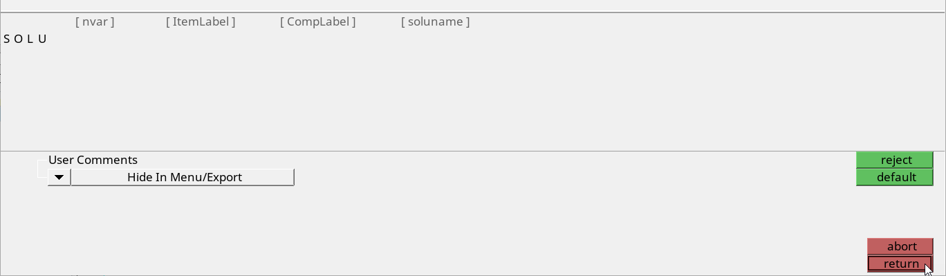

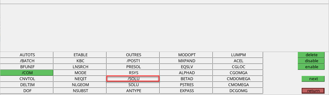

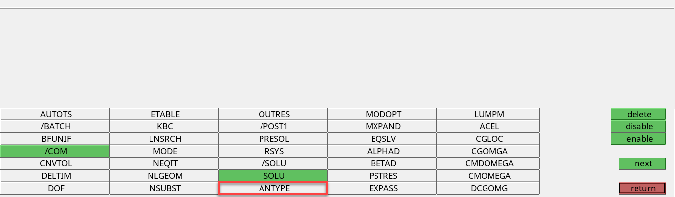

Add /SOLU, ANTYPE, and SOLVE in the Control Cards
In this step, you will add the following Control Cards.
