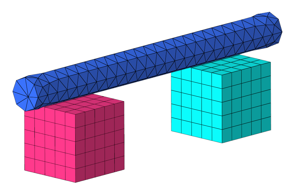

Figure 1. - In the graphics area, click once to make it the current window for keyboard commands.
Fit the model to the graphics area by pressing F.

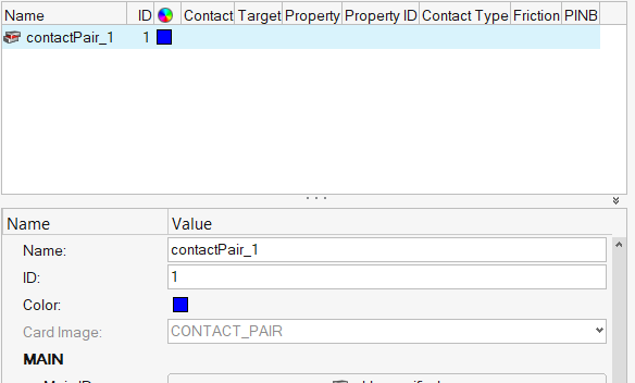

From the Model ribbon, Contacts tool group, click the
Contact Browser tool.
Figure 3. - In the second pane of the Contact Browser, right-click and select Create > Contact Pair from the context menu.

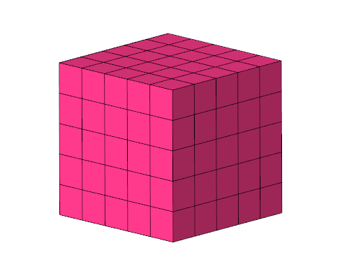

Mask the BOX_SOLID45 and CYLINDER_SOLID45 components in the first pane of the
Contact Browser.
- Right-click on the BOX_SOLID45 component.
- Select Hide from the context menu.
- Right-click on the CYLINDER_SOLID45 component.

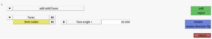

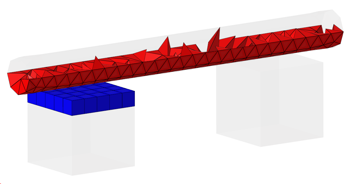

Figure 6. - In the panel area, set the first switch to add solid faces.
Set the advanced selection switch to
faces.
Figure 7. -

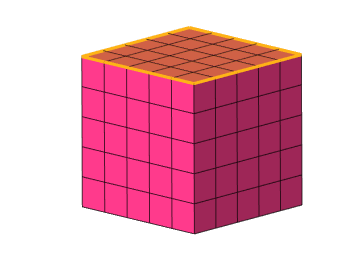

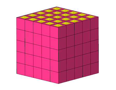

Select the top faces of the cube as indicated in Figure 8.
Figure 8. - Click add.
Observe the newly created contact surfaces.
By default, when contact surfaces are created over solid element faces, normals point outwards.

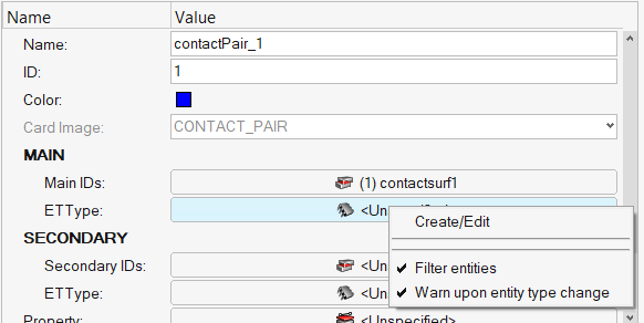

Create and attach an Et Type to the contact surface.
In theEntity Editor, under MAIN, right-click on
ETType and select
Create/Edit from the context menu.

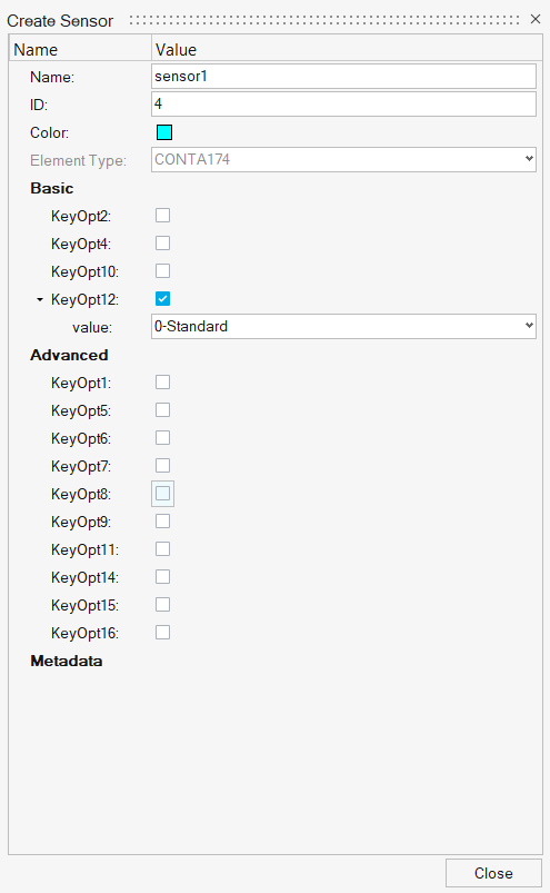

In the Create Sensors dialog, define the
sensor.
Note: By default, the Element Type is set to CONTA174.
- Enable KeyOpt12.
- Select 0-Standard from the list.
Close the dialog.

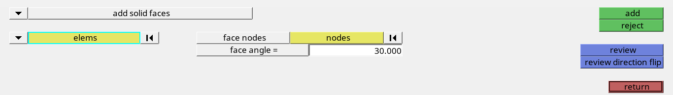

Create and attach a target (secondary) surface.
- In the Entity Editor, right-click on Secondary IDs and select Create Contact Surface using Elements from the context menu.
elems.
Figure 13. -

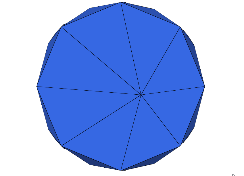

Select the elements indicated in Figure 14.
Figure 14. -

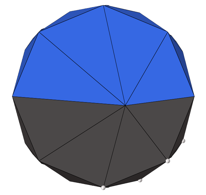

Using the nodes selector, select face nodes on the selected elements as
indicated in Figure 15.
Figure 15. -
Click add.
Surfaces are created on selected elements.

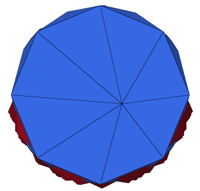

Only the main and secondary surfaces display.
Figure 17. -
Check the normals of the surfaces.
Note: Notice how the surfaces are pointing out. If the normals are facing each other then it is a valid direction. In this tutorial, the normals should be pointing at each other.

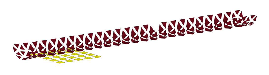

Right-click on contactPair_1 and select
Review from the context menu.
Contact regions display.

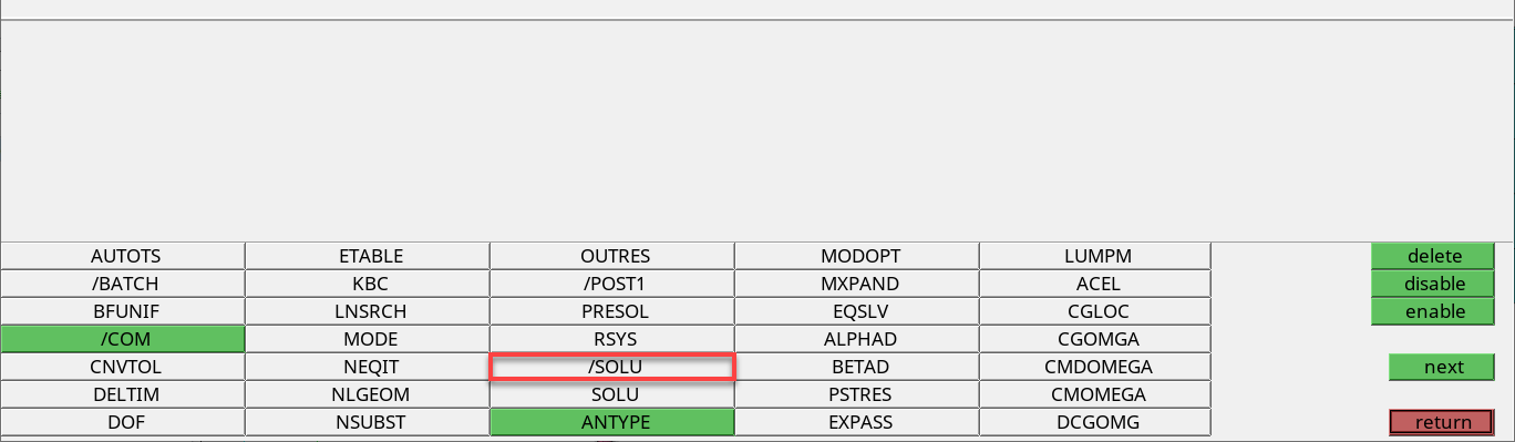

In the panel area, click Analysis > Control Cards.
The Control Cards panel opens.
Click /SOLU to exit the PREP7 preprocessor and enter the
SOLU preprocessor.
Figure 19. -
Click return.
Figure 20. -

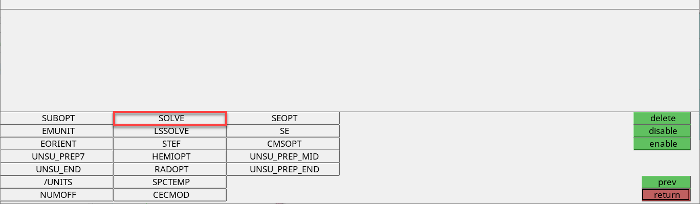

Click SOLVE.
Tip: If you do not see the SOLVE Control Card, click next.
