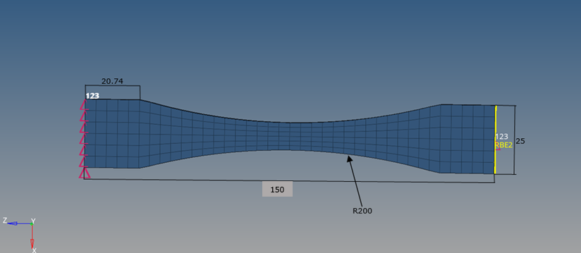

The specimen used for FEM simulation is shown below, along with its dimensions.
Figure 1. Specimen FE Model
On one side of the specimen, all the nodes are constrained to three degrees of freedom (123).
Additionally, on the other side, RBE2 is applied on the entire phase and the center of the RBE2 element is constrained to three degrees of freedom (123), along with constraint 1 DOF (1) using the SPCD entry.

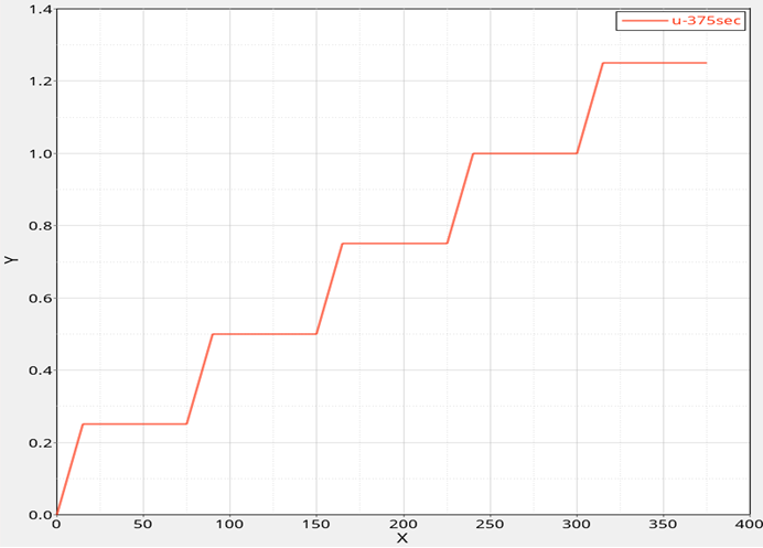

The TABLED1 Bulk Data Entry is used to apply enforced displacement in TLOAD1 and enforced temperature in TLOAD1.
Figure 2. Displacement Curve Input for 375 seconds

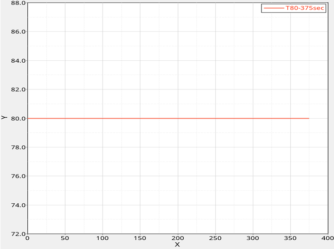

Figure 3. Temperature Curve Input for 80 degrees Celsius
Temperature load is applied to the component.

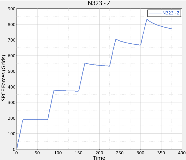

Figure 4. SPCF Forces versus Time at the center SPCD node of the RBE2

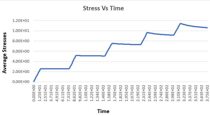

Figure 5. Average True ZZ Stresses at the cross-section of the specimen

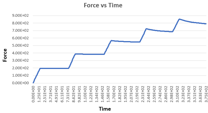

Figure 6. Force versus Time
Since Force, as an output, is not supported for solid elements, average True zz stresses at the cross-section of the specimen, along with the dynamically changing area at each timestep are used to manually calculate the force.
