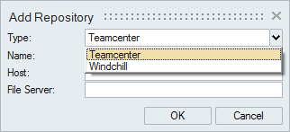

  1. Select File > PDM > Open.
  2. Add a repository.
    1. If you haven't added a repository before, the Add Repository dialog opens automatically:
    2. If you want to add an additional repository, click the Repository field and select Add Repository:
  3. For Type, select Teamcenter or Windchill.
  4. Enter the Name, Host, and File Server.
  5. Click OK.
