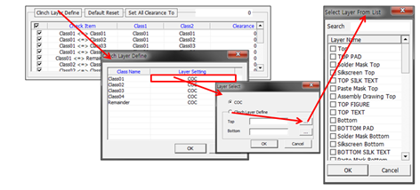

- Setting: Set layers, reset the clinch table or set the clinch clearance value as a proper value at the same time.
- Clinch Layer Define: Use the button menu to set the layer where the
clinch data exists. If reserving clinch in Component Overlap Check
(COC) data in design, it’s possible to use it. Additionally, if the
clinch is drawn in some layers for the top and bottom, define them
using the following methods.
Figure 1. - Default Reset: Reset table to default setup status. Component classes checking combination and clearance value are reset.
- Set All Clearance To: Set all clearance values with given value.
- Clinch Table: Table contains all defined component class combinations and clearance values.
