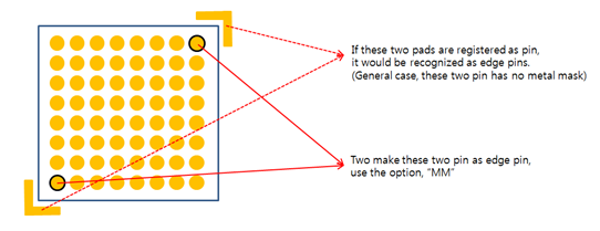

- MM: To avoid PollEx DFM recognizing the
wrong edge pin, use this option so that PollEx DFM will not treat pins that have no
metal mask as edge pins.
