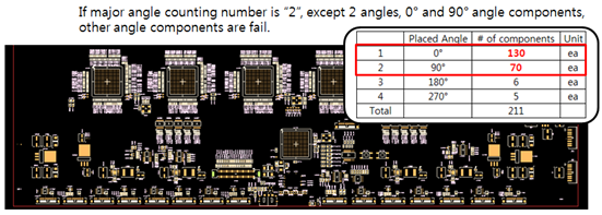

U Name Angle
Check the angle of each reference name silkscreen on design.
- Option
- Allow for Major Angle’s Counting: Count the number of major angles
for the top and bottom placed components. For example, 1 means that
PollEx DFM counts the most used angle,
and components that have a different angle will result in a fail. 2
means that PollEx DFM counts the first and
second most used angle, and other components with a different angle
