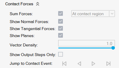

Contact Forces
The Contact Forces section allows you to control the visibility of motion contact forces.
Figure 2. Contact Forces
- Sum Forces
- This option converts several force vectors into an equivalent force/torque combination. When unchecked, the numerical value is not reported.
- Show Normal Forces
- Show or hide the contact normal force component.
- Show Tangential Forces
- Show or hide the contact friction force component.
- Show Planes
- Show or hide the planes drawn at the base of the normal vector arrow.
- Vector Density
- Use the slider to reduce the number of vectors drawn for the contact region. A value of 1 shows all of the vectors, while a value of 0 shows one.
- Show Output Steps Only
- Motion contact results typically have intermediate frames interspersed between the output steps for contact visualization. You can use this option to suppress the intermediate frames and show only the output steps. This is helpful when you want uniform time spacing between your playback output frames.
- Jump to Contact Event
- When animation playback is paused, you can jump to the first, previous, next, or last contact event. If you hold down the Previous or Next button, it will auto-repeat.

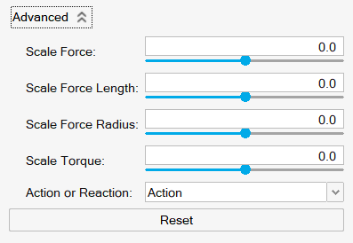

Advanced Options
The Advanced options allow you to scale motion contact forces and torques, and define whether to show action or reaction forces.
Figure 3. Advanced Options- Scale Force
- Drag the slider to scale the force vector relative to the model.
- Scale Force Length
- Drag the slider to change the length of force vectors.
- Scale Force Radius
- Drag the slider to change the radius of force vectors.
- Scale Torque
- Drag the slider to scale the torque vector relative to the model.
- Action or Reaction
- Select whether to show action forces, reaction forces, or both.
