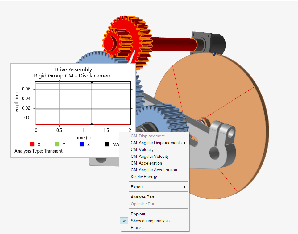

After running a motion analysis, select an object to plot in the modeling window.
Prerequisite: Run a motion analysis. When complete, a check icon appears and the Review Motion Results tool is activated.
  1. Select an object to plot in the modeling window or Model Browser. A small callout plot will appear.
  2. Right-click on the plot to see a list of available motion analysis results that can be plotted for the selected entity. (The list of options will change based on the type of entity selected.)
  3. Select the type of result to plot.
  4. Optional: When you find a plot of interest, double-click outside of the plot grid area to open a larger pop-out plot in a new window.
  5. Right-click and mouse through the check mark to exit, or double-right-click.

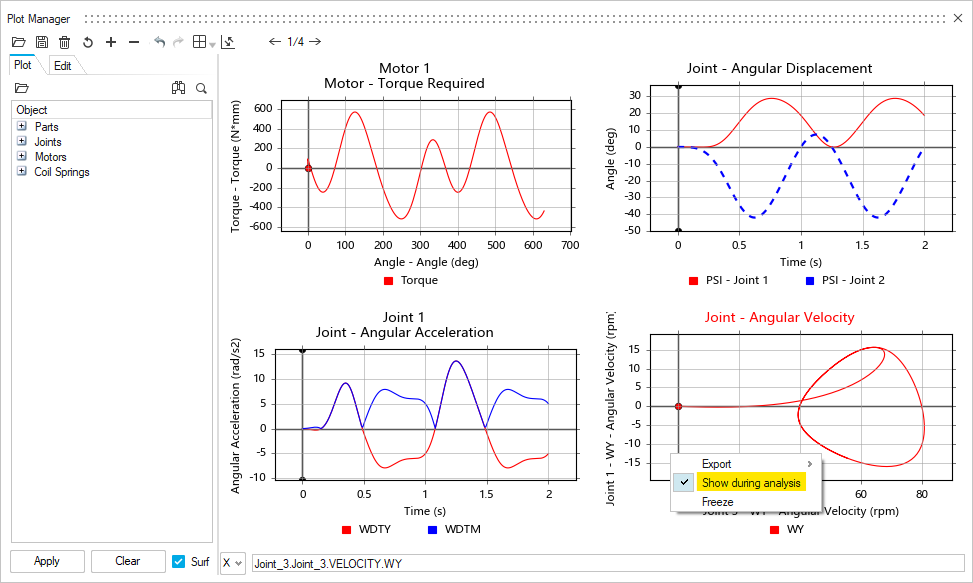

Plot Manager
Use the Plot Manager to browse and plot motion results data, create cross plots (data vs. data), define pages in different layouts, and save the plots you've defined as a template for reuse.
You can access the Plot Manager by clicking the Plot Manager icon on the motion animation toolbar.

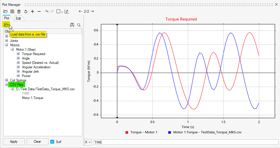

  • The Plot Manager also allows you to load data from a .csv file that you can then plot alongside your motion analysis results. This is useful for comparing results to test data or to overlay results from a different model or analysis. To use this feature, click the folder icon underneath the Plot tab to load your data, and then plot the data channels from the CSV Files container in the plot browser tree.
  • When importing .csv data, specify the units in the column headers, as shown here:

Live Plots
Plots of motion results update live while solving, and will appear when you click on entities in the Model Browser or if an entity is selected in the graphics window.
If you create or author a plot using the Plot Manager, you can use the Show during analysis option to show it live during the motion analysis. This also works for cross plots where the x-axis is not Time.
The live plot will remain displayed between runs until you manually close the plot.

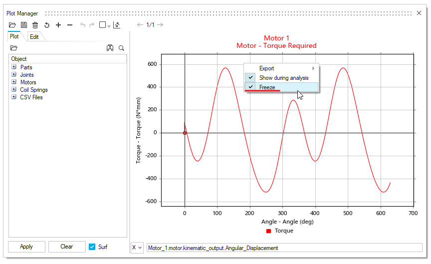

Freeze for Overlay Plotting
You can freeze a plot to allow results comparisons between different runs by right-clicking a pop-out plot in the modeling window, or by right-clicking the plot in the Plot Manager. Select Freeze or Show During Analysis from the corresponding context menu.

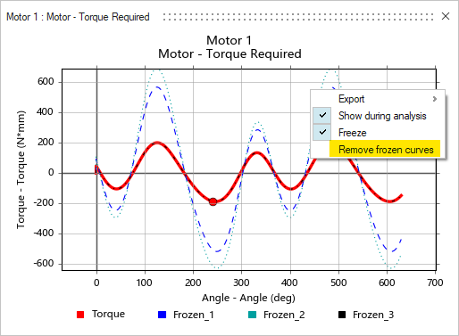

Enabling the Freeze option on an authored plot specifies that after the next run, a copy of the newly plotted curve will be automatically generated at the end of the motion analysis. This frozen copy of the curve will persist on the plot during each subsequent analysis, allowing you to compare motion runs.
This feature works best when used in combination with the Show during analysis option, which creates a persistent live plot. It allows you to compare changes against frozen curves from prior runs without needing to invoke the Plot Manager after each motion analysis.
The Remove frozen curves option is a convenient way of deleting all of the frozen curves at once, and is available from the context menu on a live plot when reviewing motion results.
