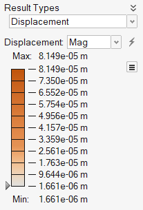

Displacement
The displacement result type shows how much your model displaces or deflects when loads and supports are applied. The areas of the model that are the darkest orange have the most displacement.
- Order of magnitude
- Does the magnitude of the displacement make sense? If a component that is 100 mm long has a displacement of 1000 mm, this indicates that either the load magnitudes are incorrect or the model is not properly supported. This may also be caused by incorrect material properties.
- Shape of the deformation
- By animating the model for each load, you can check that the structure is deflecting in a logical way. Unusual behavior is usually the result of incorrectly applied loads and/or supports.

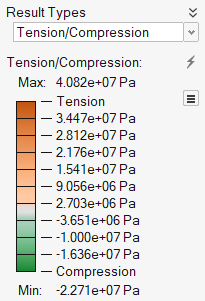

Tension and Compression
The tension and compression result type shows which areas of the model are in tension and which are in compression. These results are derived from the signed von Mises stress results.

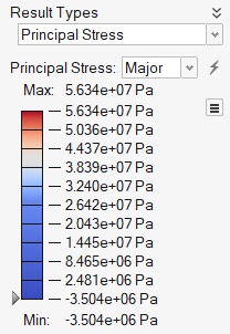

Principal Stress
The results in the Analysis Explorer include several stress types including major and minor principal stress. These stress results can be used in various failure theories to predict part performance and durability.
By default, areas shown in red have exceeded the peak stress, which is the highest
displayed stress for the selected load case. To change the top number in the legend to
the yield stress for a material in the model, click the
icon next to the results slider in the Analysis Explorer.
You can also click on the top number and define a custom value.

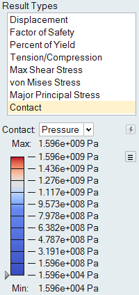

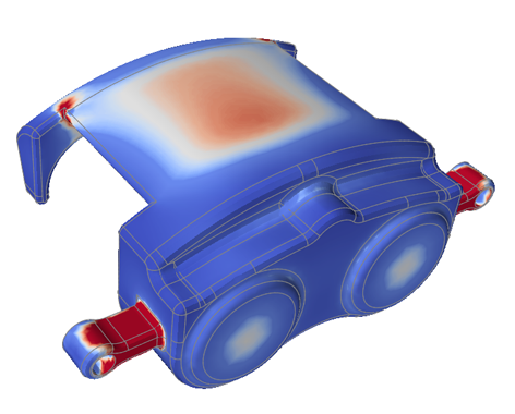

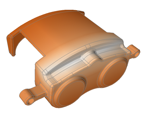

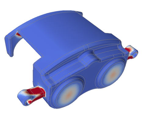

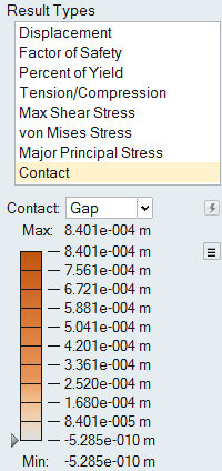

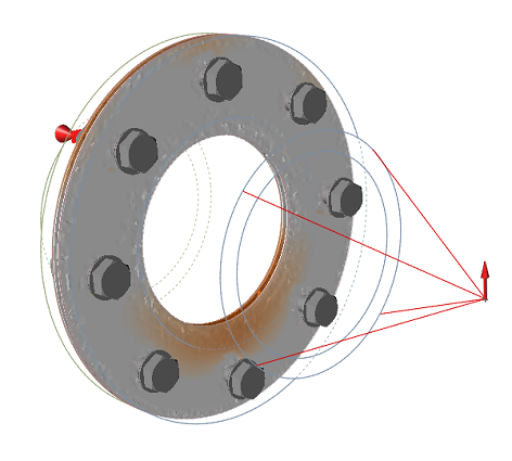

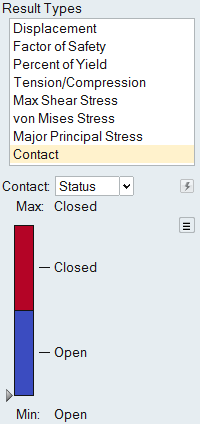

Contact (results)
The contact result type allows you to view contact gap, status, and pressure to ensure that the contact is behaving appropriately. It also extracts contact force results for normal, tangential, and traction forces.

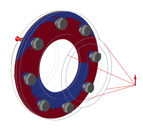

A typical use case would be reviewing the contact pressure over the gasket area in a pipe flange to ensure that the gasket doesn't leak.
- There are contacts in the model that have been defined as contacting (as opposed to bonded).
- The linear static analysis was run with Sliding or Separating contact types defined.
If these conditions are met, then a contact analysis is automatically run as part of the overall analysis and appears as a result type in the Analysis Explorer.

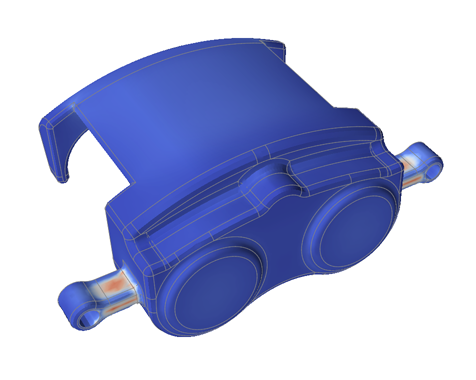

Figure 1. Example 1: Contact Gap Result

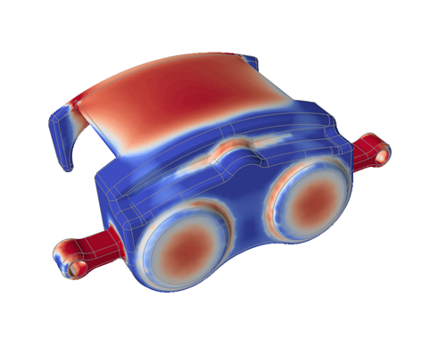

Figure 2. Example 2: Contact Status Result

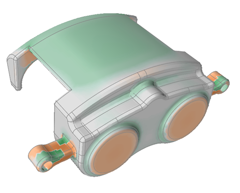

Figure 3. Example 3: Contact Pressure Result
